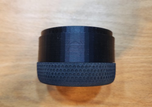

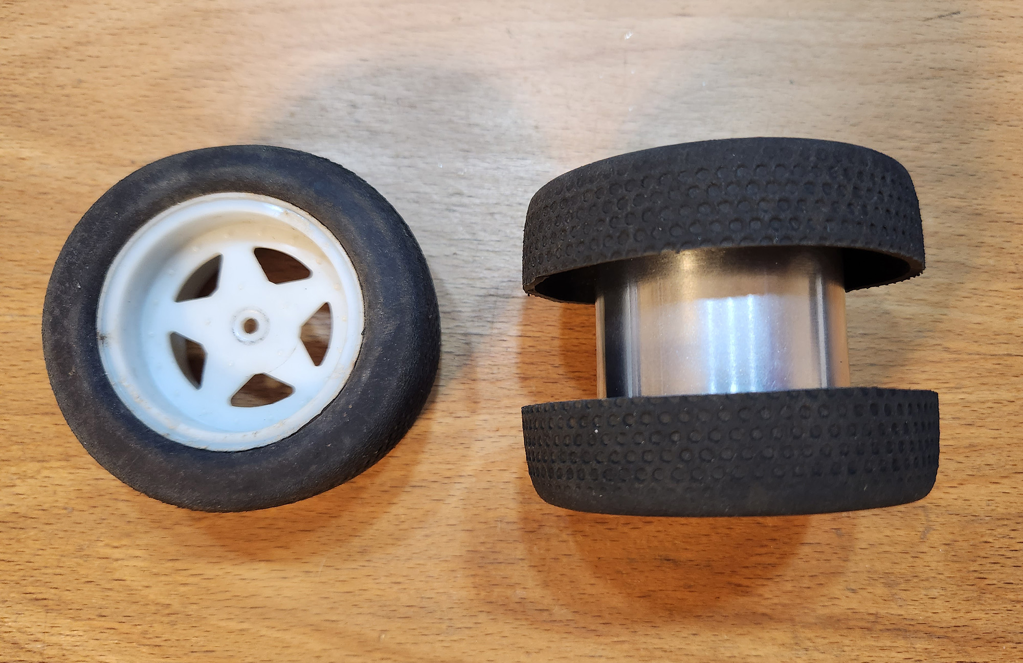

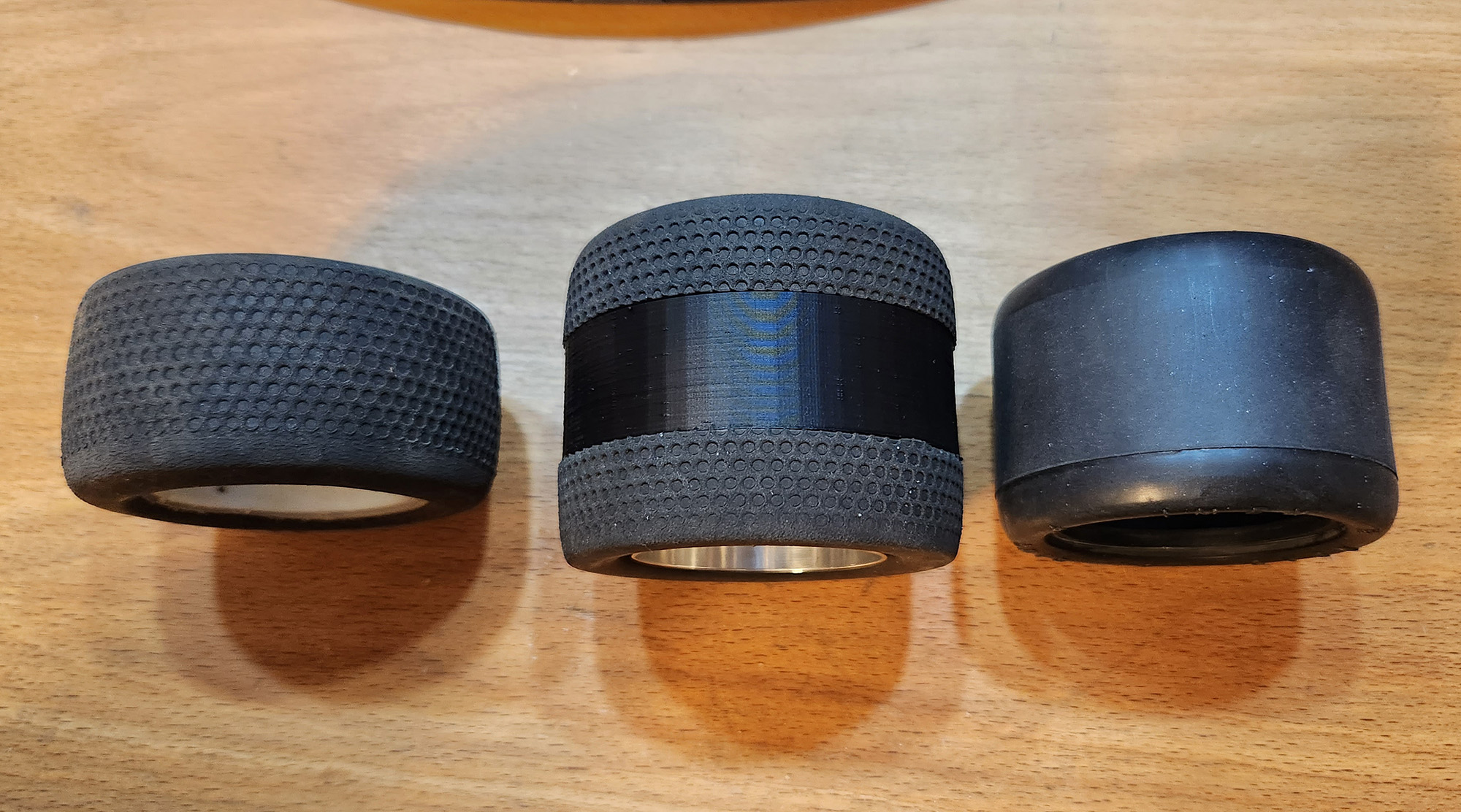

After a couple of weeks of searching for 2.5" wide rubber drag slicks unsuccessfully, I decided to try to make my own.
And after looking further into the originals I was looking for, that is exactly what the manufacturer did! They basically had their sidewalls, and they retreaded the top with a slick. Like capping a foam, but not over the sidewall. You can see the tread butt joints in this pick, along with how the tread doesn't quite line up with the lower tire to the right. I wish I had an original set to prove this, and see how narrow the original tires were, but no such luck.
Now, I don't plan to do anywhere near as nice of a job as the manufacturer, but figured I would try it. I don't know what these tires were originally, but they are being sacrificed now for drag slicks. The center fill is printed TPE, which is about .5mm too narrow in this first version. When all this is glued up, the plan is to cover it all with a stretched bicycle tube tread. No idea if this is going to work out, but fun to play with in the meantime.

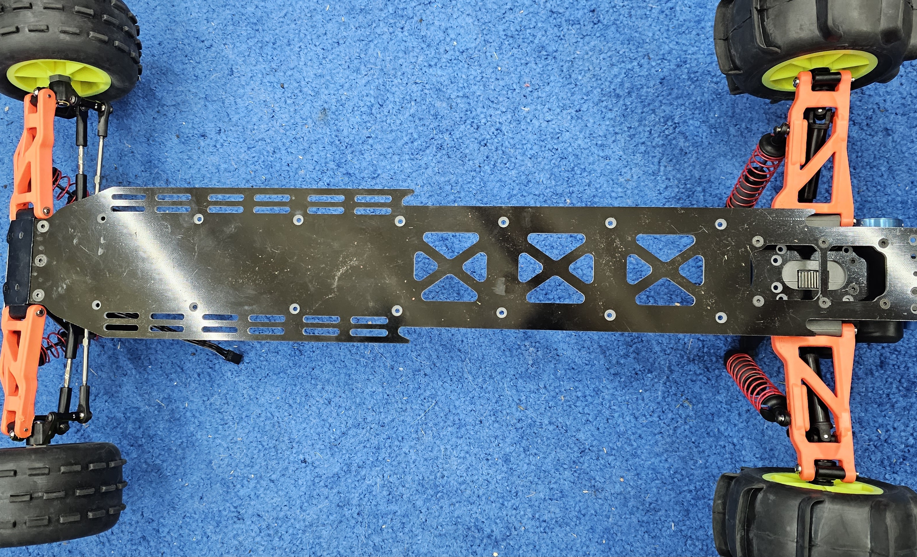

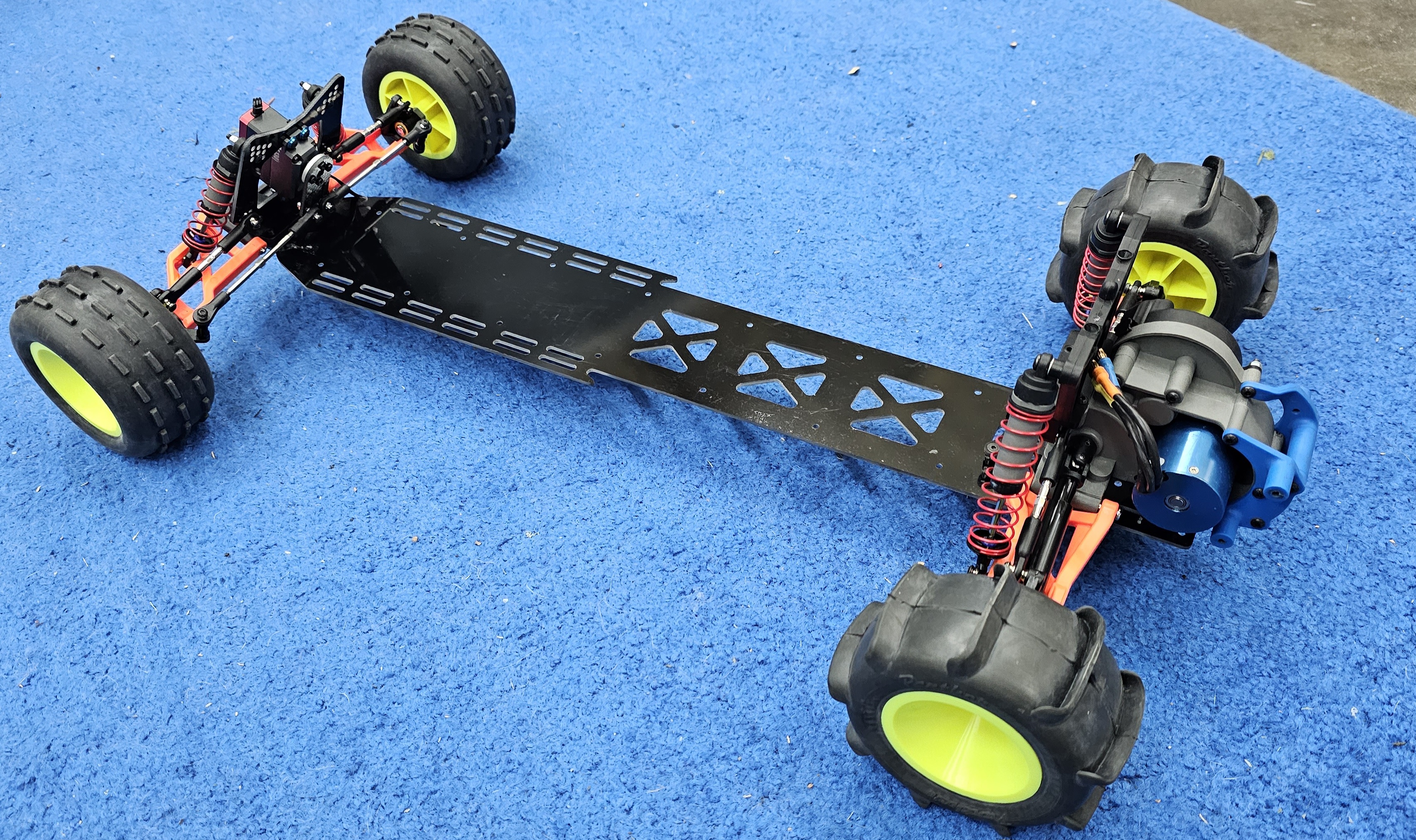

Sand drags are becoming popular with no prep winding down for the year. So, it was time to build a 18" wheelbase sand chassis
sadly it's Traxxas but I didn't have to buy anything from them so it's ok

I think you should strongly consider an upper chassis to eliminate the slight flex that may be present from the wheelbase

Hey, I have those rear wheels and tyres! Project time!!!
- Posts: 12336
- Has thanked: 1129 times
- Been thanked: 3919 times

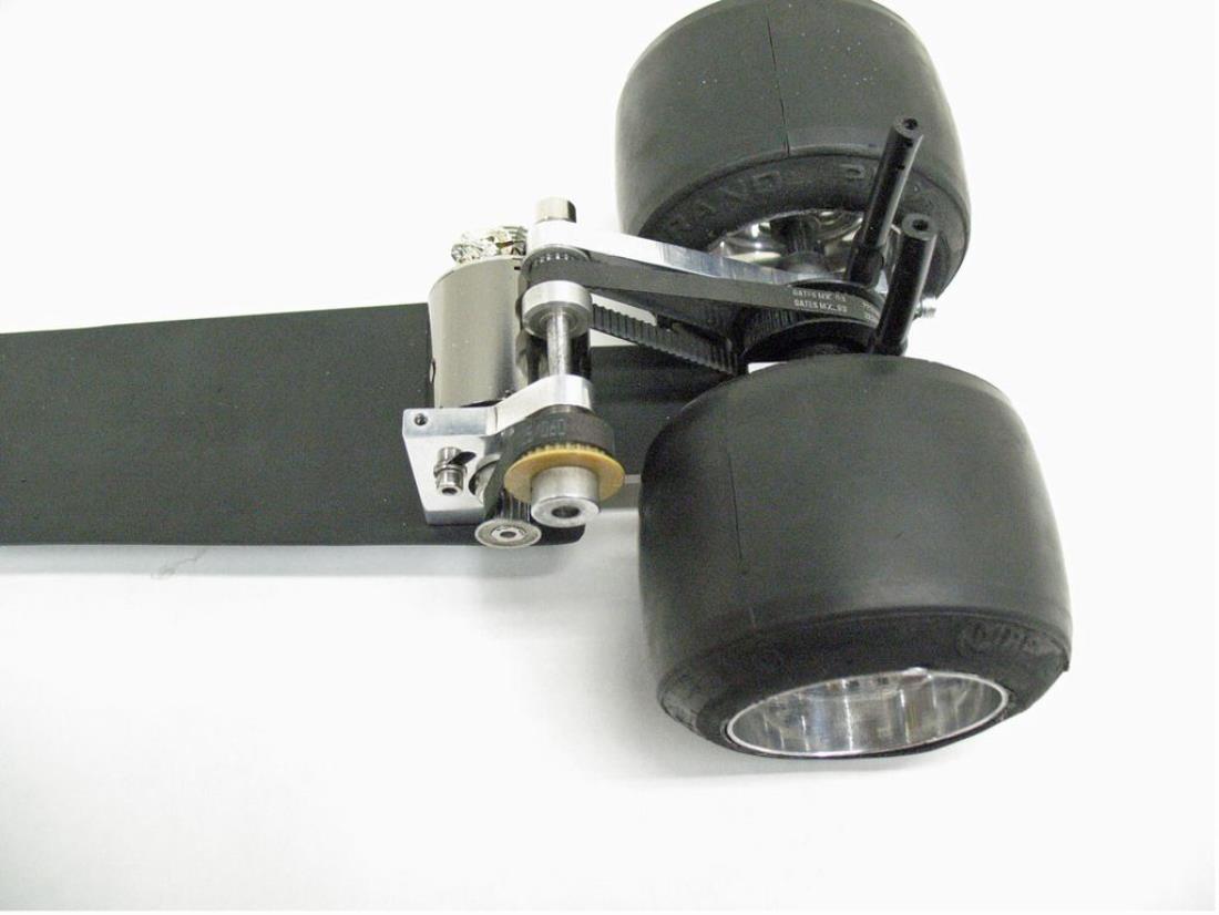

Outdated for competition but good placeholders! I don't even know what the guys are running competitively

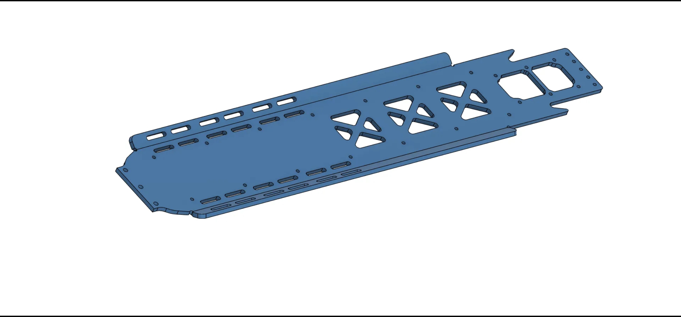

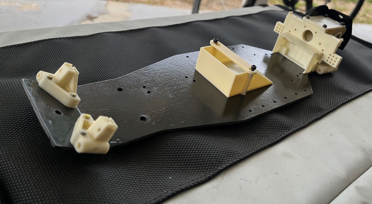

The two options we have are aluminum with bent sides or 5mm carbon fiber with the option to add side rails. Guys are running 4mm carbon currently and the flex isn't that terrible. Since weight isn't a huge concern I am liking the aluminum option. Here's what I have being cut to test with
