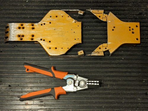

A lot more work to do still, but at least the fun part is out of the way now and I can start the tedious frustrating detailed part. 😂

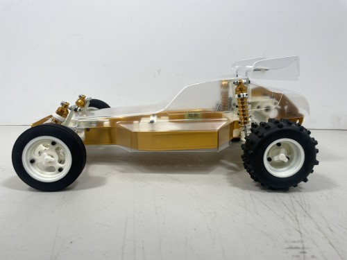

My first ever NIB buggy build.

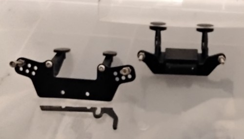

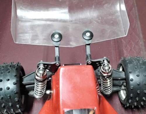

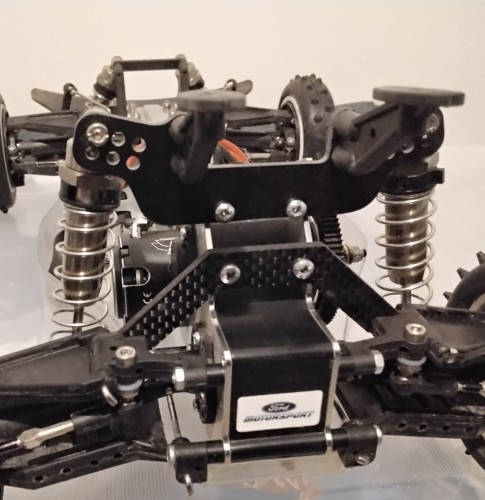

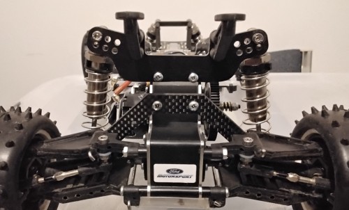

I hacked away at a perfectly good Factory Works rear shock tower for a Cougar. :? I finished the project with the same number of fingers I had when I started. That is normally how I define success. In this case, though, I actually achieved my goals. :D
The XLS upper shock mount and wing wire proved to be to fragile for my erratic driving. I broke the mount a couple of times and had to reshape the wire after literally every run. I updated the whole assembly with re-re Pro CAT parts. This eliminated the wing wire, but also pulled the tops of the shocks in a bit- very close to the body. It was fully functional, so I ran it for a while, but the body was very difficult to install or remove. I had to trim it a lot more than I wanted back around the spur gear- not ideal for where I run.
The Factory Works Cougar rear tower uses B6 wing mounts and provides 6 (vs 1) upper shock locations. Perfect. I knew the Cougar tower could be modified to fit as I had done the opposite when I raced carpet oval. I had used inverted XLS bits on a Cougar to lower it.

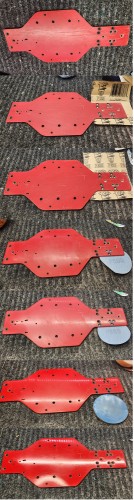

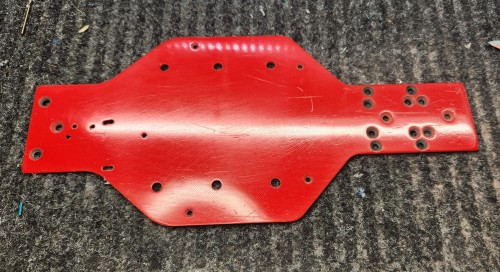

Quickie clean up of a Hot Trick Chassis, which would be the same as any G10 chassis. 15 minutes and a $15 HFT headlight kit. I had to go a couple of courses rougher than the kit, but still about 15 minutes and 15 bucks. Chassis isn't perfect, but it never will be. I took it as far down as I was comfortable with.
edit: now that I post that and see the close up, I can do better. I'll go back to 500g or so.
