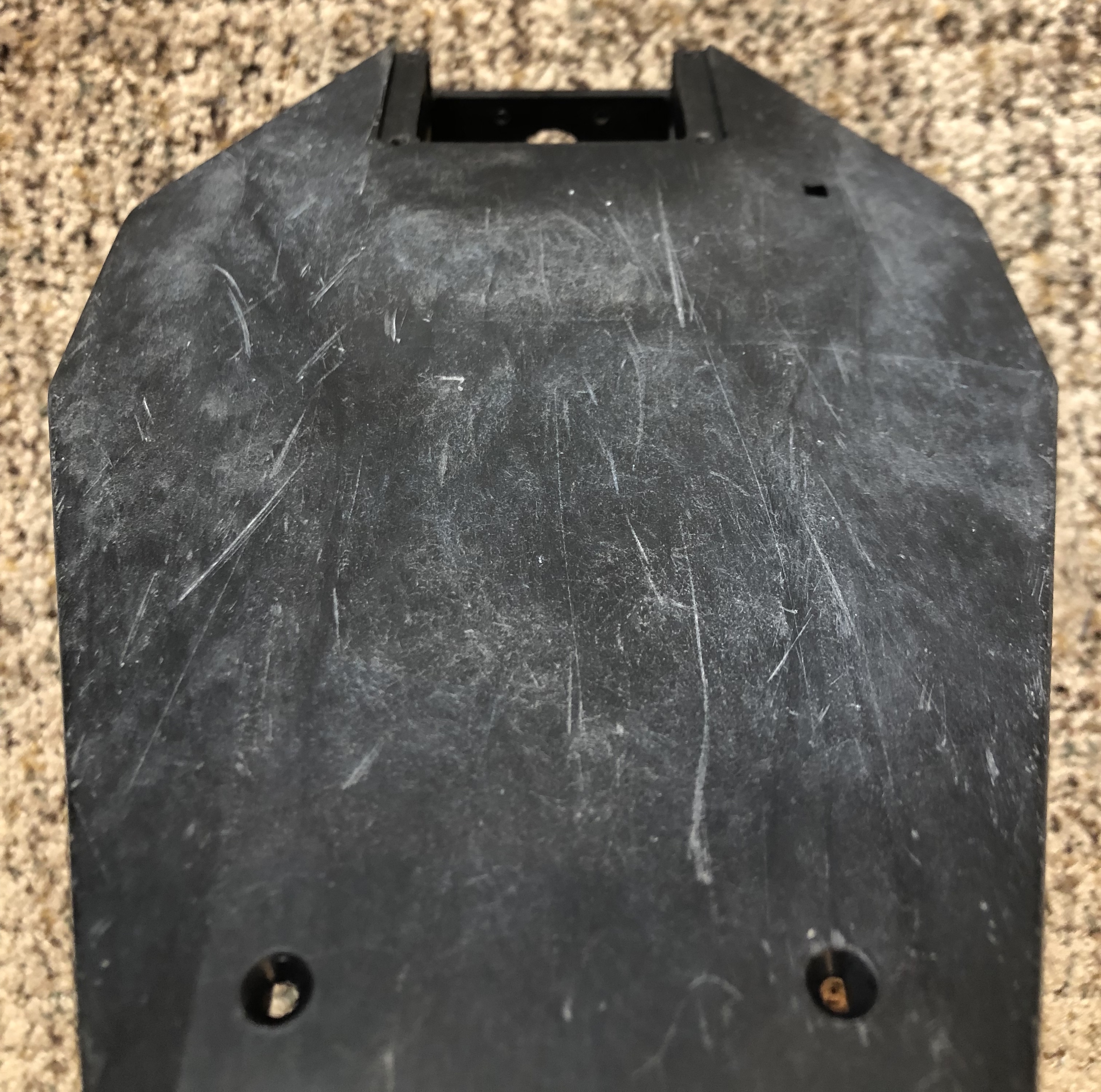

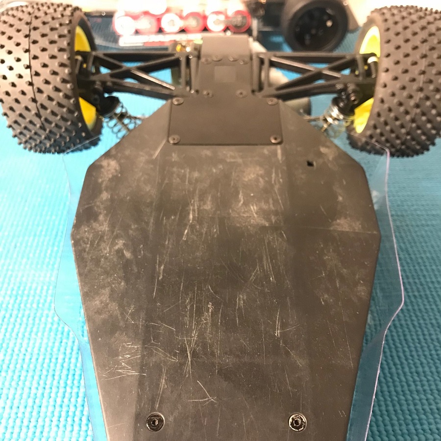

Has anyone had any experience removing scratches or small gouges from composite plastic chassis, specifically of the B2/B3 variety?
If so, what method(s) did you find yield the best result?

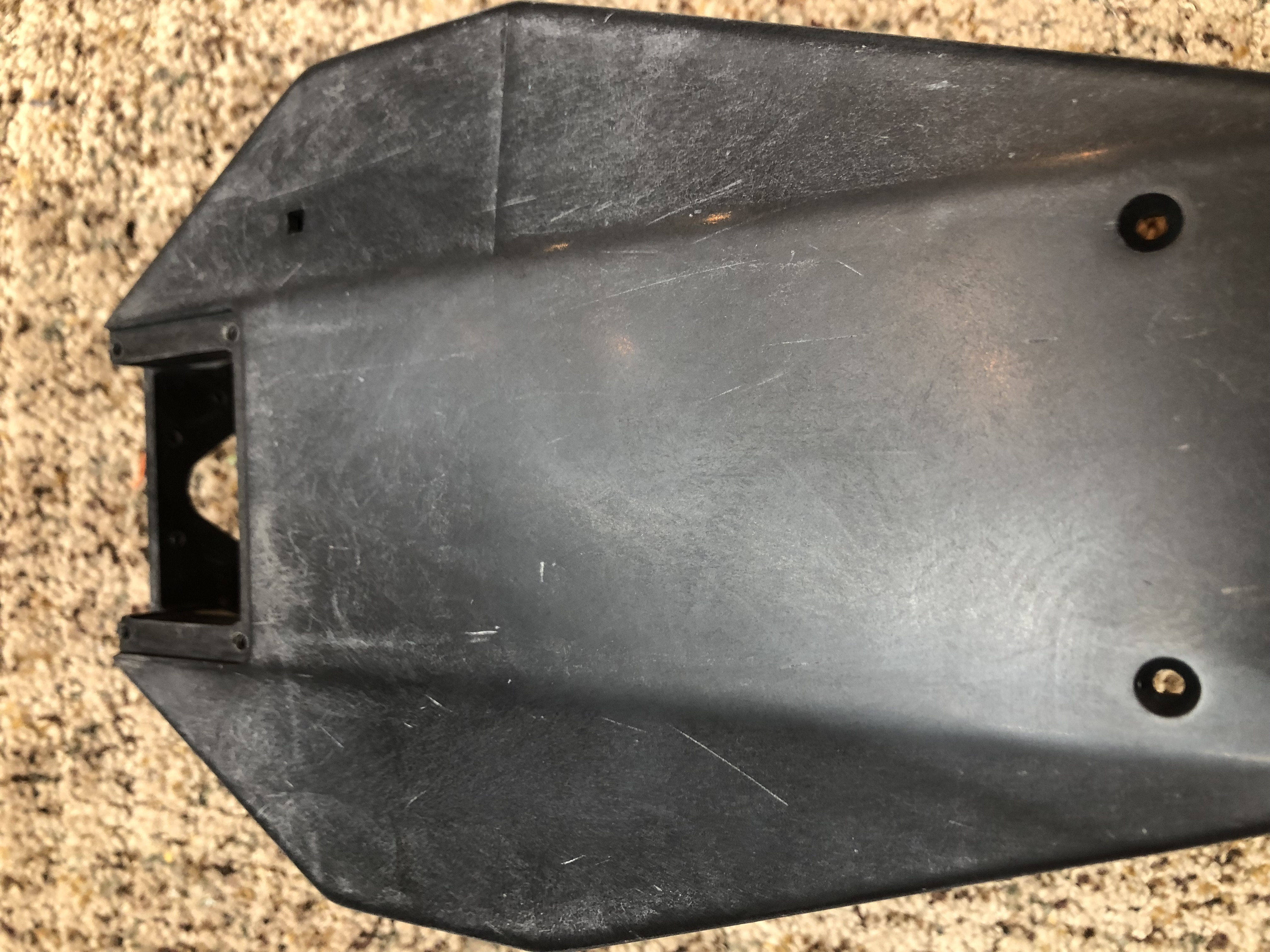

Started with 360, to 600, and finished with 1500, all wet sanded. Still have some deeper scratches to go, but I was getting disappointed with the result as it seems to be polishing the plastic too much and rounding the sharp lines. Media blasting sounds interesting, I might have to research that a bit. Was also considering getting a finish dual action sander and trying that.
Maybe the polish look will grown on me, and I'll try either WD40 or the Armorall.
More to come...
More to come...
