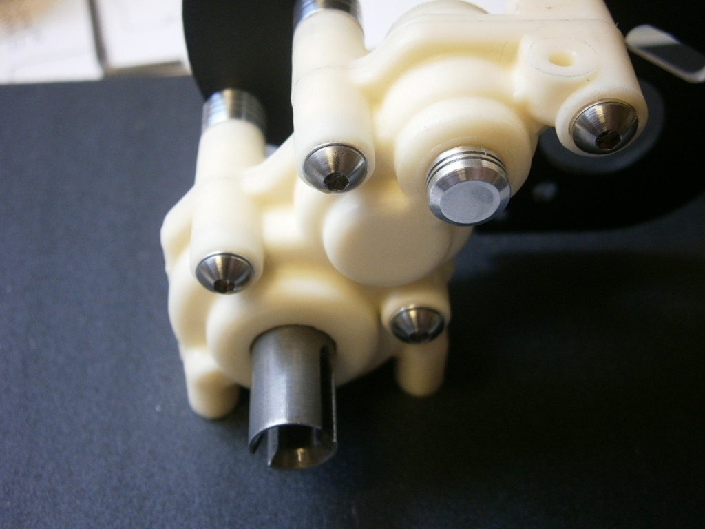

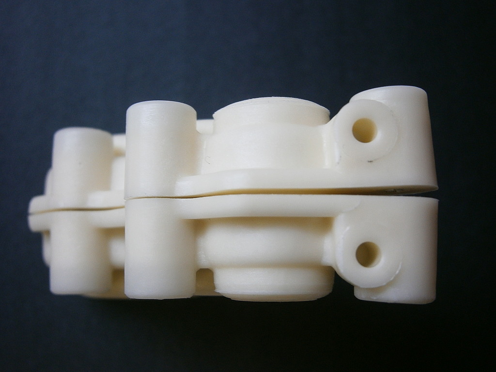

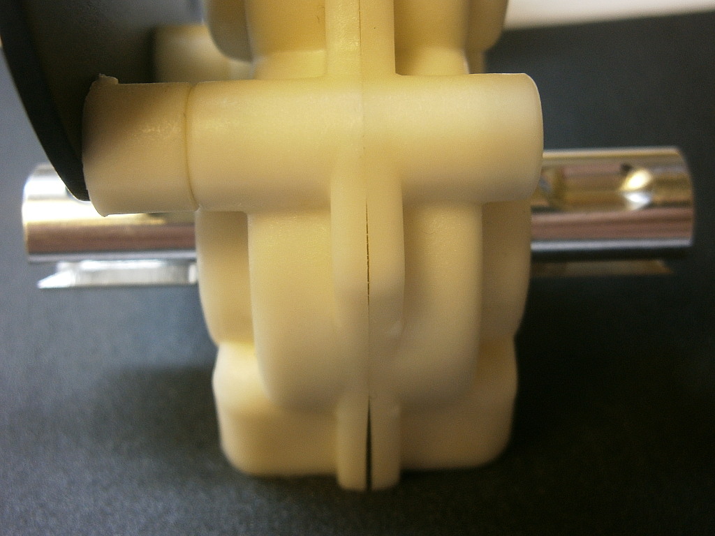

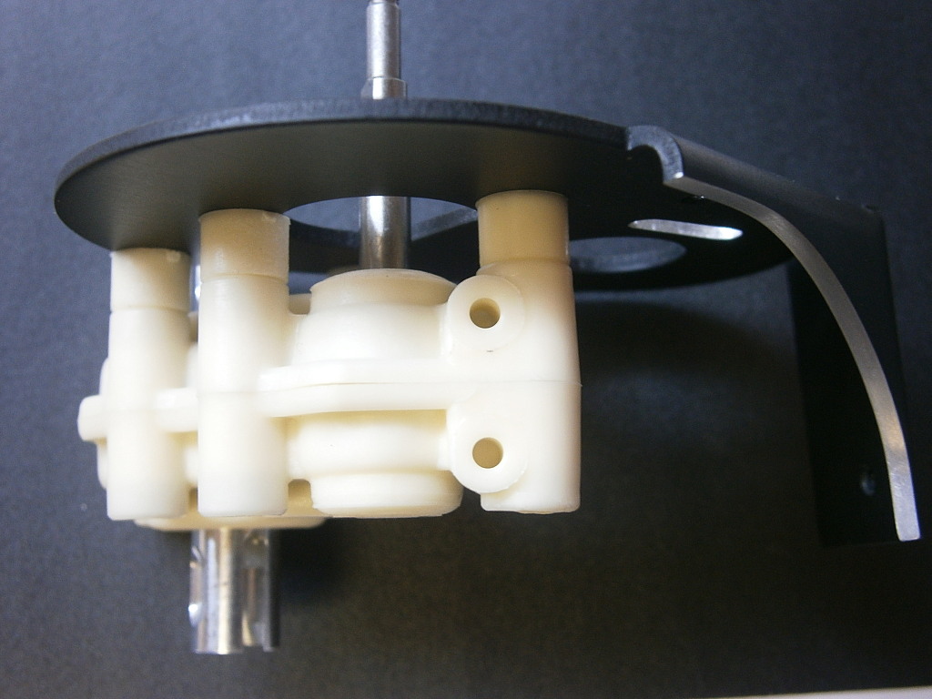

I just got this new 6565 Stealth trans case yesterday, bought off of eBay. The plastic is different, a lighter color than the beige ones.
The cases have a severe warp, not cool at all. I'm really bummed out about this. I'll not buy a bunch of them in the hope of getting a good one.
(click the pic for full size)

stupid Q: when you put internals in and you tighten it gently, does it bind? In other words, is it just cosmetics, or there is a true structural issue to it?

Ive had older ones do that as well. They pull together. I would fire off an email to associated though and see if they will bin check them and send you “fresh” replacements.

The trans cases do pull together as @GoMachV says. I've used all new parts (6580,9601,6570) and fresh Avid bearings. The diff outdrives are CPD aluminum. The screws are snugged up, no torque on them. As you can see, there's still some gaps in the case that can suck up dirt/dust. The bottom gap may close slightly once bolted in a chassis. There's no drag or notchy feeling at all in the tranny, smooth. It will get even better once broken in.

not uncommon. all of the ones I've ever seen have some bit of gap here or there. as long as the two halves mate and the inner lip doesn't hang you should be good. That inner lip provides most of the sealing.

Try screwing the halves together and put it in boiling water for a little while. Let it cool while it's still screwed together. Maybe put a bolt through the out drive holes too.
I've done that with a warped Kyosho trans case before and it helped.

Hey mate, I got the parts to build the diff this morning.. built it
I've got 0.005" play, side to side. I'd say that is acceptable.
