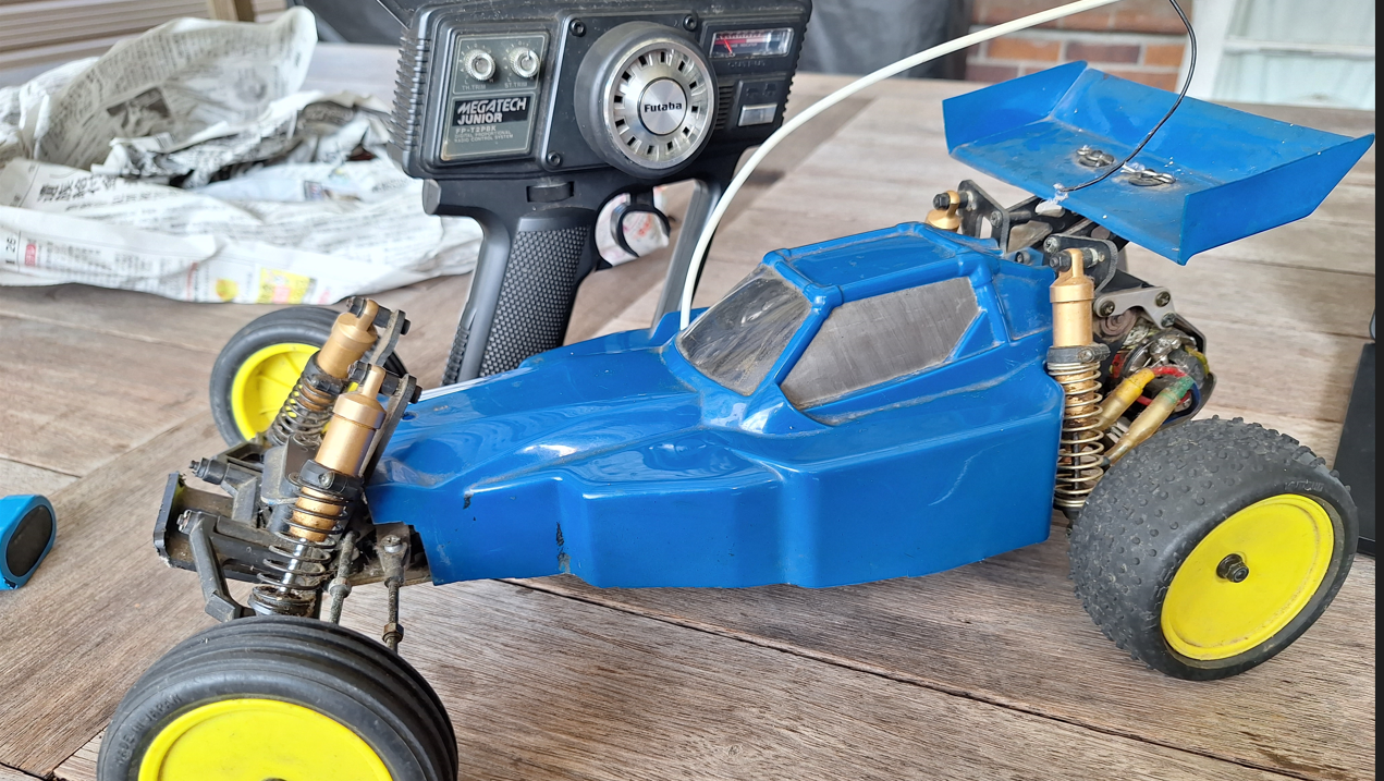

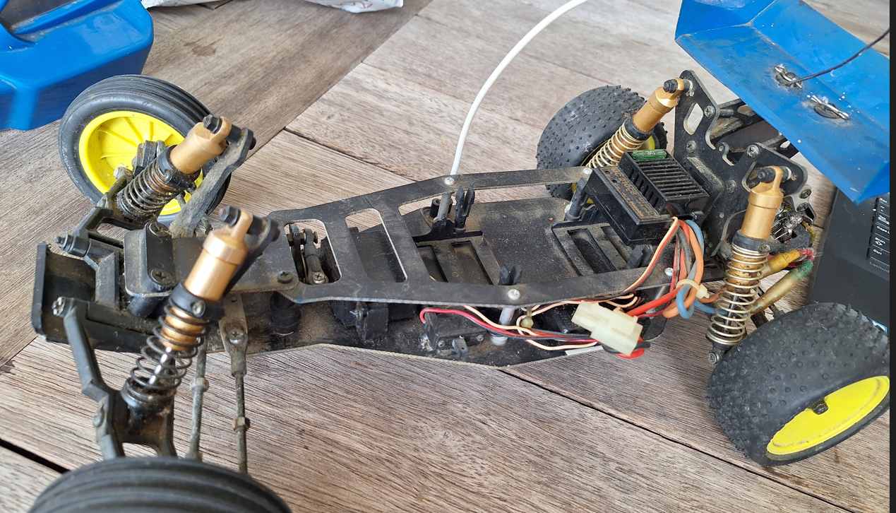

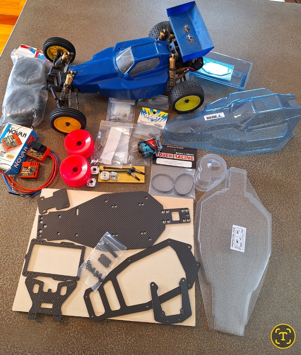

Been looking for last couple of years and grabbed this from Japan.
No one really rates these but ive always has a soft spot for them from the old Hobby City days in Auckland,
This one needs CVD's and the battery clips etc, but not in bad nick.
The double belt gearbox is supposed to be pretty inefficent, but some retrofit gearbox parts coming up on shapeways to fit RE RE differentials and gears now too.
Ill see if the belts are salvageable first.
Came with the Futaba Megatech and MC210CB and that impressive S148 Standard servo.
Maybe a winter project, covert the slipper from 0.6 to true 48dp too.

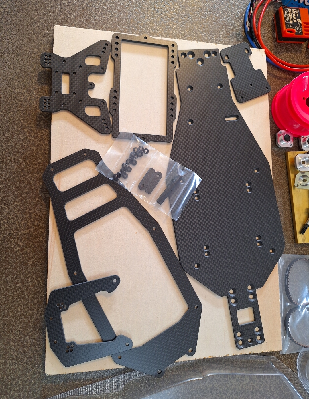

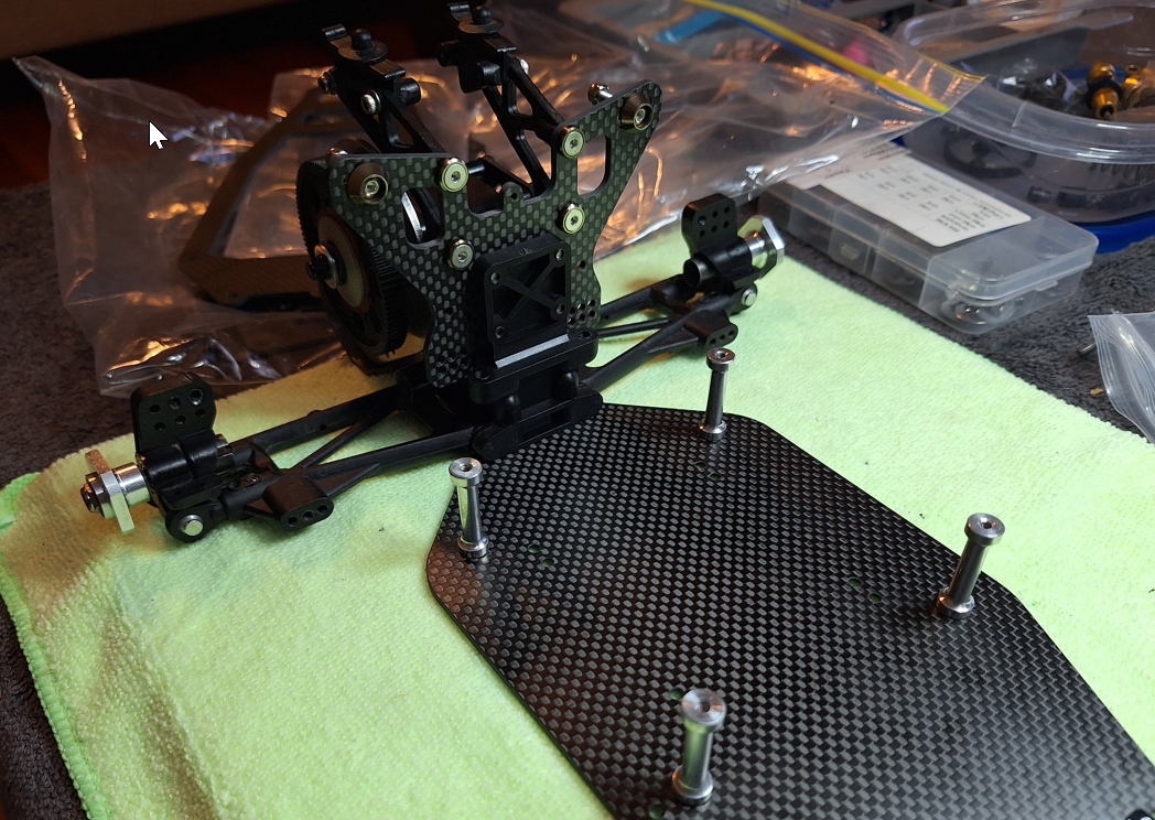

I'm such a sucker for carbon, Back in the day it was so exclusive and hard to get.
Paul Sims at Bezerk sorted me out, and custom cut a shorty lipo cradle to suit the factory drill pattern too.
Did a great job
Did a great job

Re: Finally found a Triumph

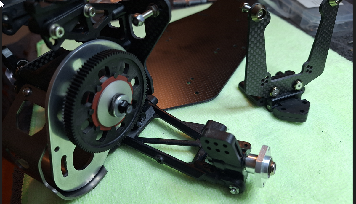

Also a few other bits to add eventually, not sure about the electronics yet, I am planning to run it.
Team Penguin does an undertay and gear cover, the rest is TBG, always quality.
Belts (TM17) were hard to source, found tough racing, but they have a sketchy looking website and wouldn't ship to New Zealand?
Never come across that before.
Sourced via guy on here via Australia ( thanks Trev) part # TRTB164
Also may use up other shiny bits I have around, have almost all 4.40 and 3mm fasteners, and the Triumph uses some 4mm,
Fallen down the rabbit hole of starting too many projects now, Procat, XLS, PB Maxima, and even my Rocky is covered in a film of dust and dissapointment.
So let's start another.......

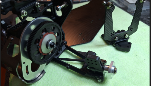

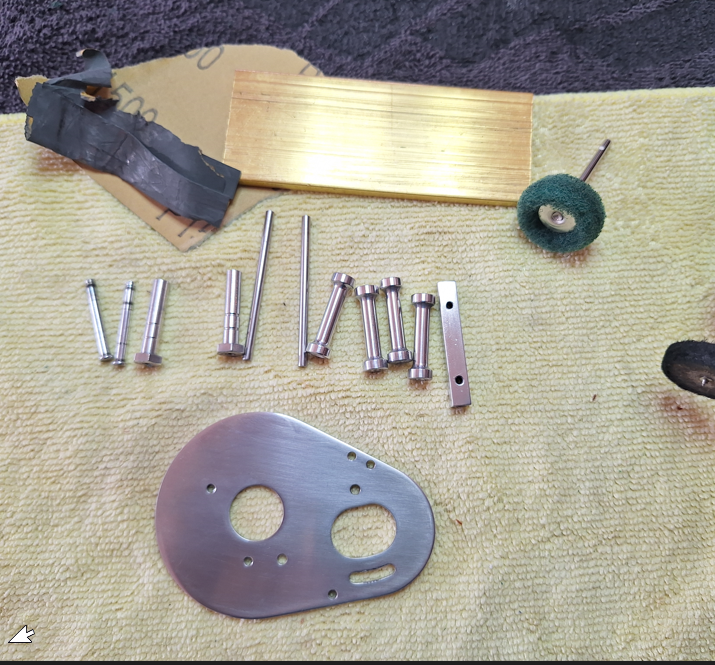

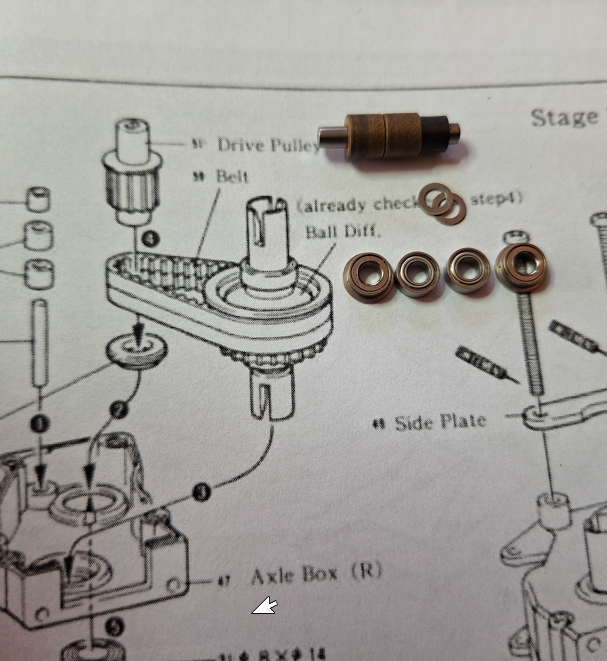

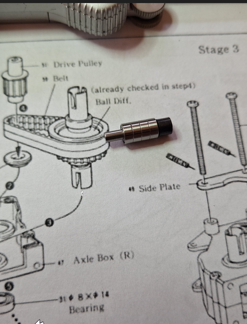

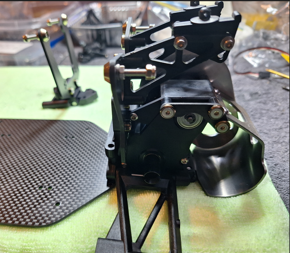

Got the belts today and started a strip down rebuild,
Still waiting on bits, but couldn't help myself. As I'm sure loads of you people can attest to...
Had a rainy Sunday so polished some bits with sandpapaer and brass polish
What I've read on these cars all say the gearbox is inefficient etc so thought id start by swapping out the brass belt tension idler with bearings,
Tried a few permeations before settling on non-flanged.
Also only installed one belt.
Luckily the ball Diff was mint, replaced the balls and bearings anyway though.

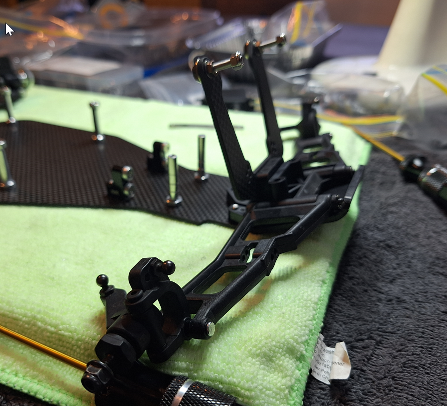

Hand cut a gearbox brace and started to come together.
Replaced all the screws with Stainless cap screws as i was going.
The wing mounts tapped to M2.5 but I'm not sure if I'll keep it as I found the JJ ultima wing kits, and I'm liking the old school wire thing.
See how it pans out.
