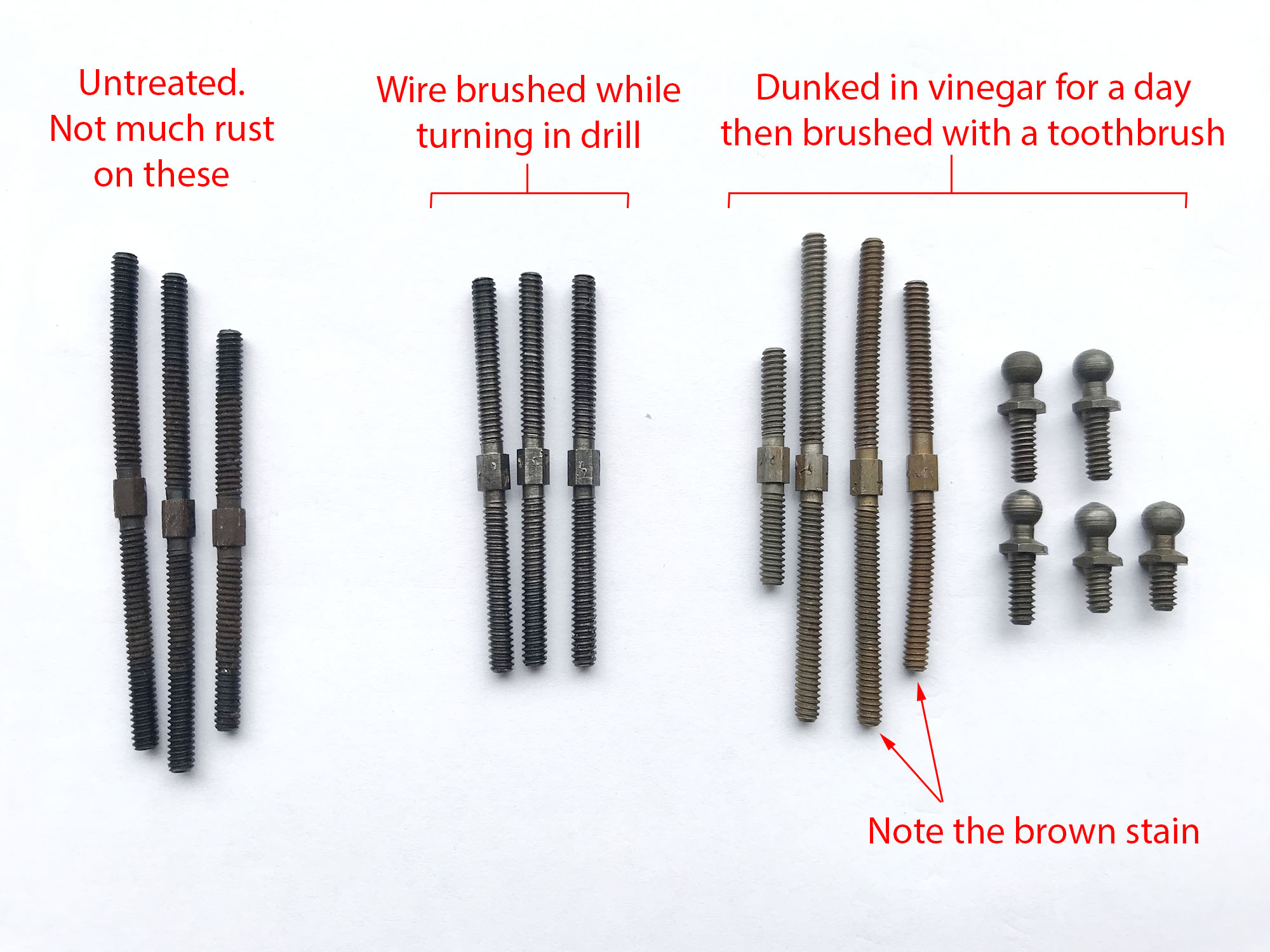

Removing rust from turnbuckles
I wanted to share my results after trying a couple of methods for removing rust from some turnbuckles.
A few I dunked in vinegar overnight along with some ball ends.
Another few I turned in a drill while scrubbing them with a fine wire brush.
Both methods worked and both have stripped the parts from their blackend finish, as well as the rust.
The brushed parts resulted in a shiny finish, while the ones that went into vinegar have a dull grey finish.
The vinegar approach was less effort.
The vinegar, additionally, seems to have stained some of the parts a shade of brown. I’m not sure why it’s been selective though

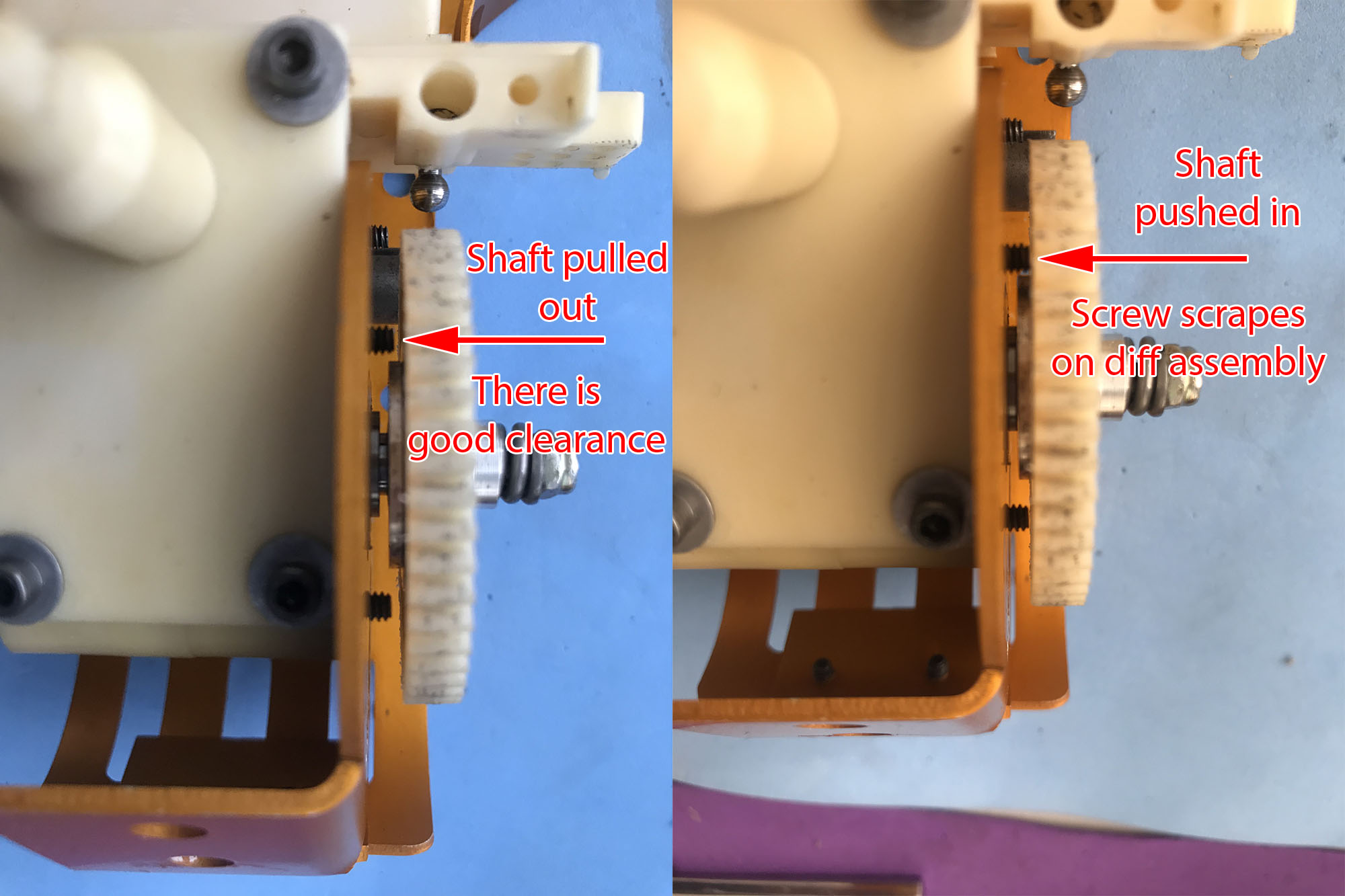

I'm getting quite a bit of axial play in the differential shaft (six gear). This is giving me some concern because, if the shaft is pushed all the way in, the inner diff drive ring contacts one of the screws coming through the transmission casing. See pic below.
Anyone had this experience? I could add a washer to set the screw back, but I wonder if the shaft should have this much play.
Thanks for any help.
Chris
- jwscab
- Posts: 6580
- Location: Chalfont, PA
- Been thanked: 505 times
Re: RC10 Cadillac A-Stamp Restore Attempt
There is a lot of play on the top shaft, you can shim it. But those screws look like they are sticking out pretty far. They should be barely proud of the motor plate. I'd add a washer behind the screw heads.
- Bakauata
- Posts: 207
- Joined: Sat Mar 09, 2019 6:11 am
- Location: Buenos Aires, Argentina
- Has thanked: 35 times
- Been thanked: 23 times
Thanks for the prompt reply.
I wonder why the screws are protruding so much. They’re the right length (1”).

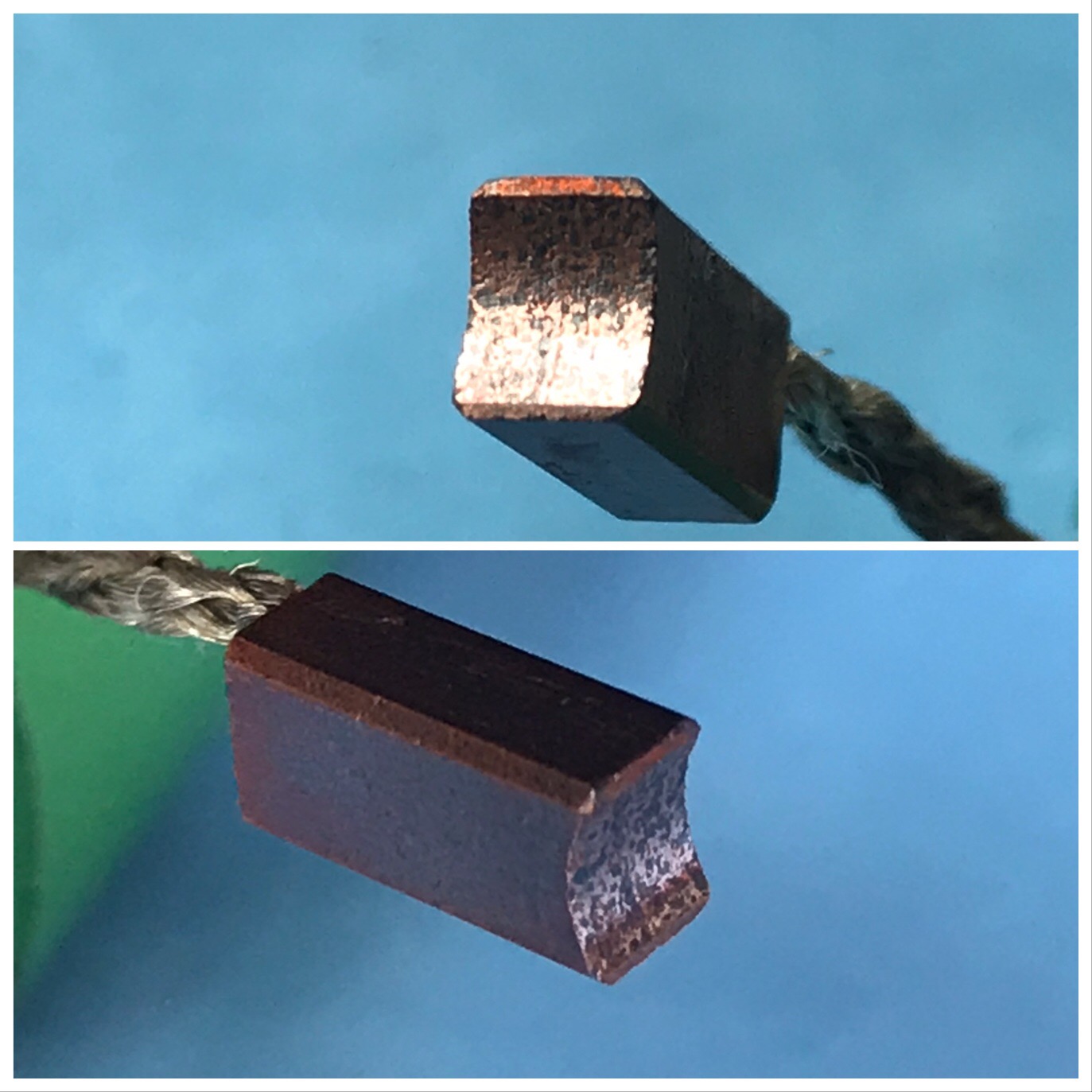

Motor brushes maintenance
Hi all.
I’m moving on to the power and electronics on this car, and have been reading up un brushed motor cleaning and restoring.
This car is for my 7yo, so I’m fitting it with a used Trinity Green Machine 2. I believe it’s the slowest used motor I have.
So far I have run in a glass of water for a short while at around 5 volts, and then rinsed with alcohol. I’ve cleaned the brushes and their slots also with alcohol and cotton swab. I haven’t touched the commutator yet. I have a comm stick which I’ll probably use on it.
My question is in regards to the brushes, which look quite pitted, or contaminated. Not really sure.
Should I try to sand, or clean the contact surface other than using an eraser on it?
I can’t find much information online on the subject.
Chris
- jwscab
- Posts: 6580
nah, don't worry too much about the brushes. You aren't trying to eek out every last ounce of power out of the motor and the brushes will wear in no problem.
as for doing the water trick and then rinsing in alcohol, make sure you apply some light oil to the bushings for the motor shaft. that by far is the most critical to smooth performance.
