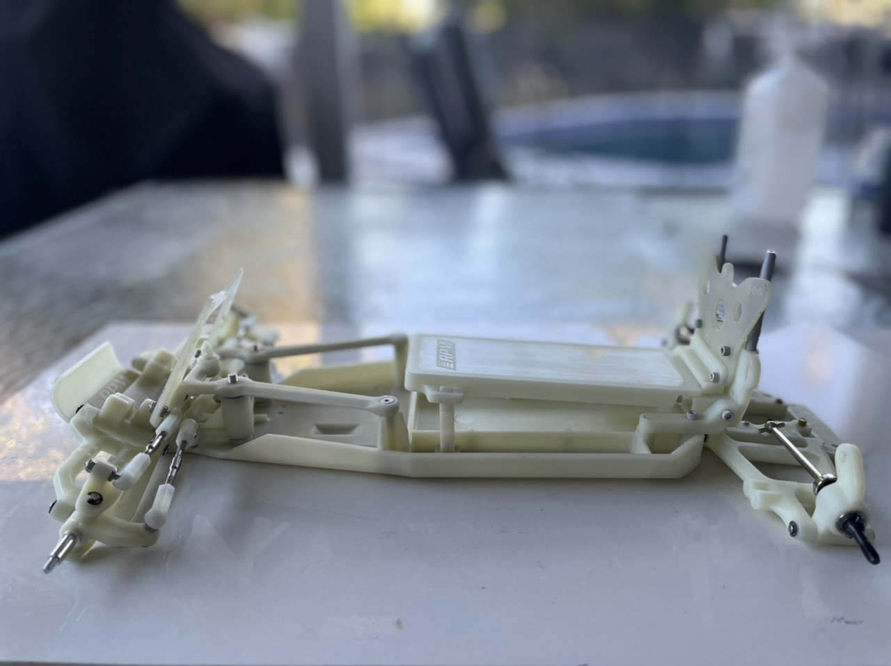

A stunning find , even I'm saying not a runner ! , the add mention dyable so its very likely Nylon and I'd try Rehydrating it , just stick all the plastic bits in a bucket of water for 24 hours , it costs nothing except time .
JosephS
Posts: 1818
Has thanked: 1209 times
Been thanked: 610 times
Re: Rpm rc10bum

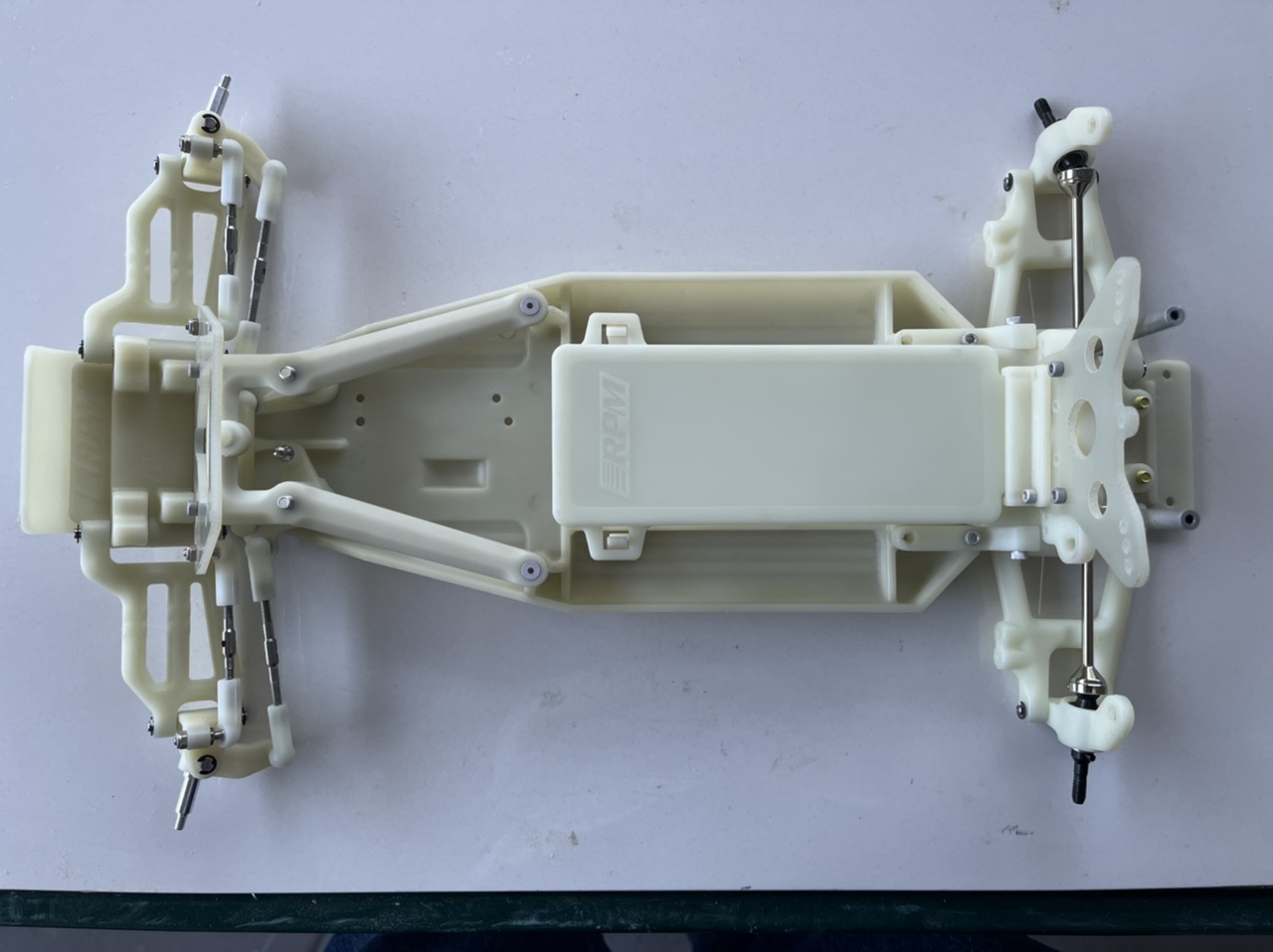

Post by JosephS »
Looks like it used to be shelf built. The transmission brace and bulk head are threaded from installation but none of the shock mounts or servo mount holes look disturbed.
It has the 3degree rear blocks installed.
MarkyDents
Posts: 1185
Location: Staten Island, N.Y.
Has thanked: 1802 times
Been thanked: 642 times
Re: Rpm rc10bum
Post by MarkyDents »
4 tecnacraft ti turnbuckles and shiny mip cvds as well,
very nice !
Sure would be sweet with two pairs of black mip shocks :D
Hey Cru ! Go balls out 8)

Post by JosephS »
jcwrks wrote: Sat Jul 02, 2022 2:07 pm JosephS, I believe I have a white trans brace.
Great to know. I want to see about getting a full parts list together before I start buying but the offer is nice.
It looks like it’s missing
  • transmission brace
  • motor mount brace
  • 1.5 degree rear arm mount
  • delrin shock pivots
  • original instructions
  • header card

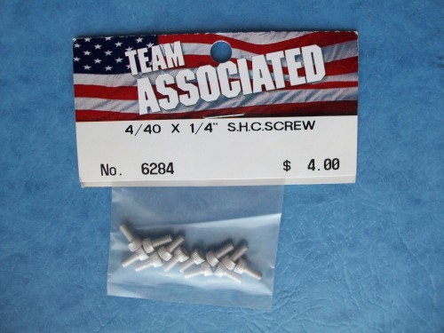

Post by JosephS »
What kind of finish is on the screws?
These are grey aluminum screws .They aren't silver like I have seen for other anodized hardware. I have managed to get some original associated aluminum screws with the same finish. The associated part numbers are the same as the blue parts.
Does anyone know the name of the finish? Is there a generic source of these screws?
Posts: 12214
Has thanked: 1084 times
Been thanked: 3762 times
Re: Rpm rc10bum
AE sourced the blue screws from fastener express. They do offer natural screws as well. Might have a look and see if those are the ones they used.

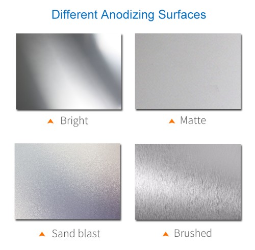

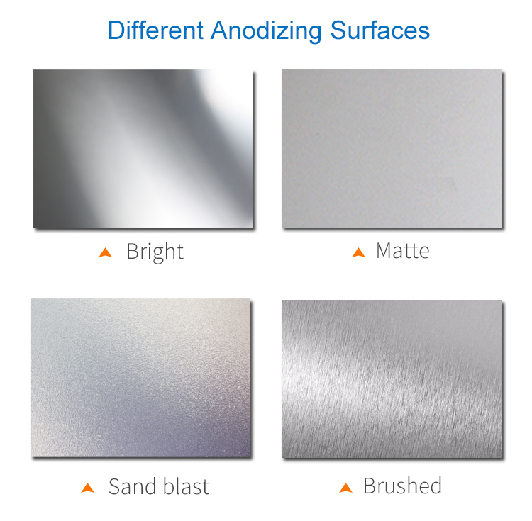

Post by JosephS »
GoMachV wrote: Tue Jul 05, 2022 2:49 pm AE sourced the blue screws from fastener express. They do offer natural screws as well. Might have a look and see if those are the ones they used.
I'll have to figure out how to take a proper picture of the differences. I am beginning to think that the screws are hard coated grey.
Normal aluminum screws look like the 'Bright' finish. The screws I'm looking at are more like the 'Matte.'
It's hard to see in a picture, but it's grey and not shiny like a natural finish.
Posts: 3677
Has thanked: 2520 times
Been thanked: 2824 times
Re: Rpm rc10bum
Bare aluminum oxidizes and dulls over time. Basically the same as anodizing, just without pigment. They could also have been purposely clear anodized.
