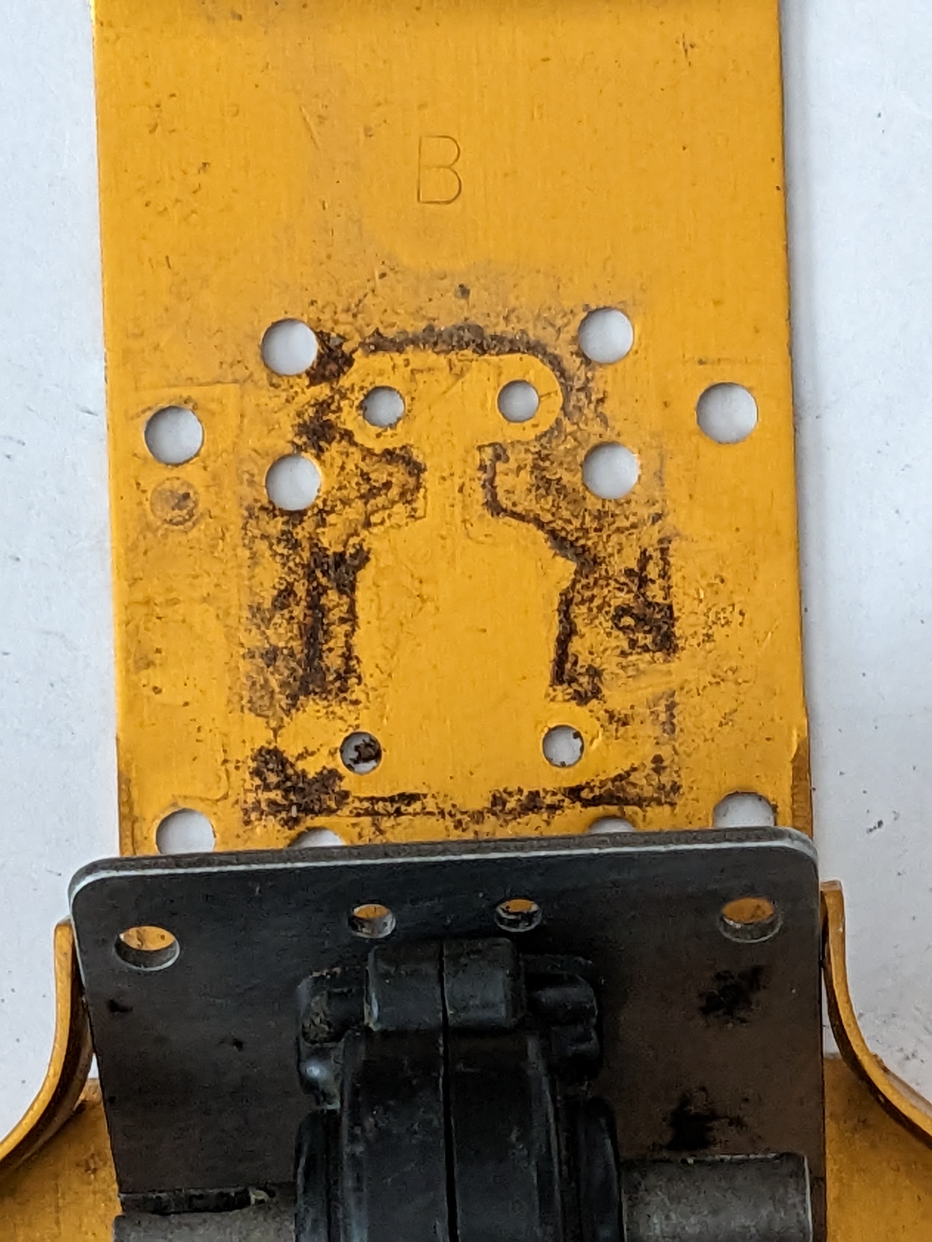

The one I just bought says in the listing that it has a B - stamped chassis. Unless I'm mistaken, I should be able to bolt a stealth gearbox to it without drilling any holes?

All B stamp have stealth holes.
Gt box won’t bolt up at all tho

Yes a B stamp tub will be for a stealth trans. It’ll bolt right in no drilling required.

An RC10 stealth will fit but the GT stealth won't fit as it's completely different, it uses a different transmission case and a differential.

Re: RC10 with RC10gt gearbox?
Not a direct fit. Shown with Stealth drill template and B chassis.
