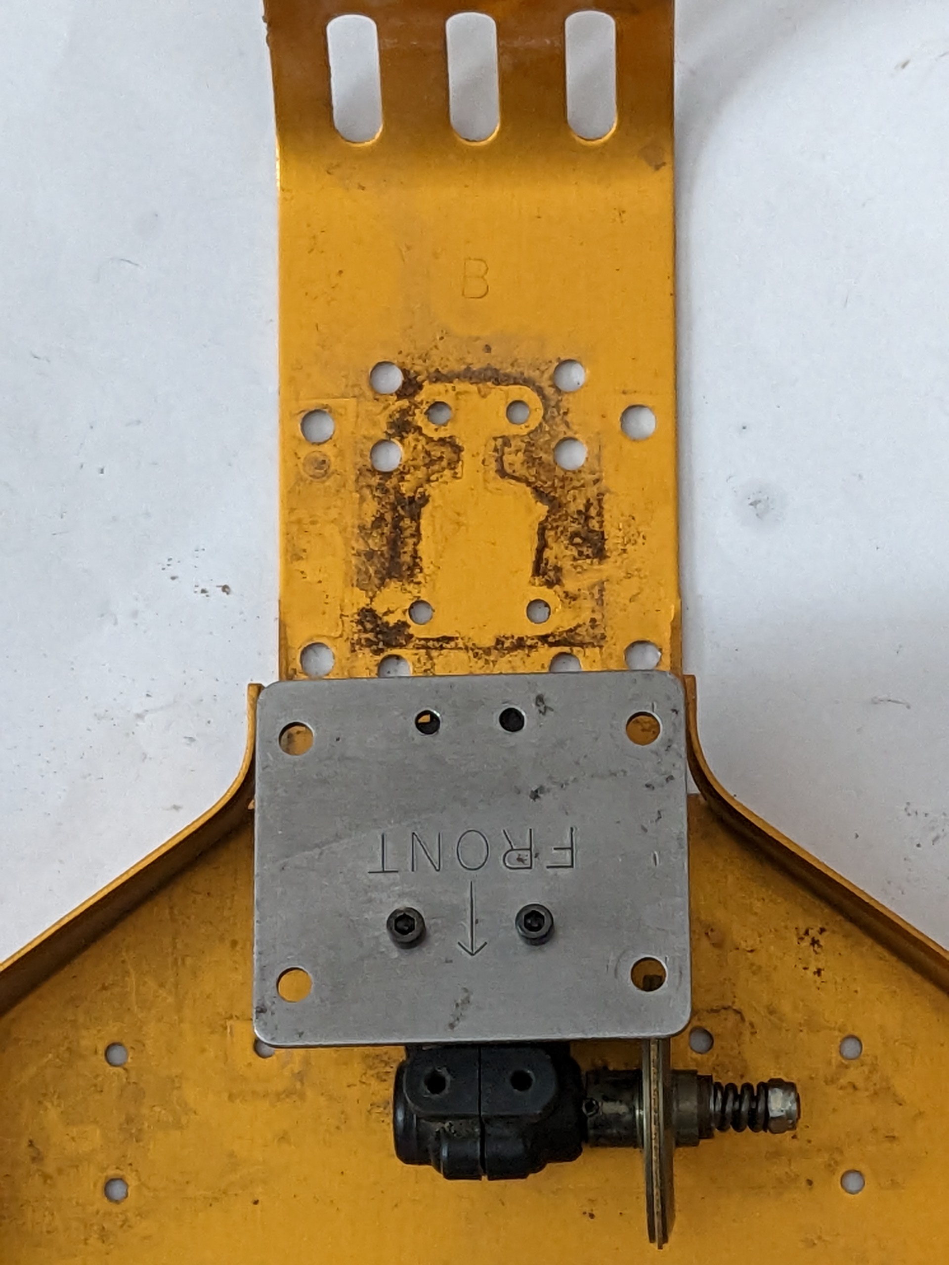

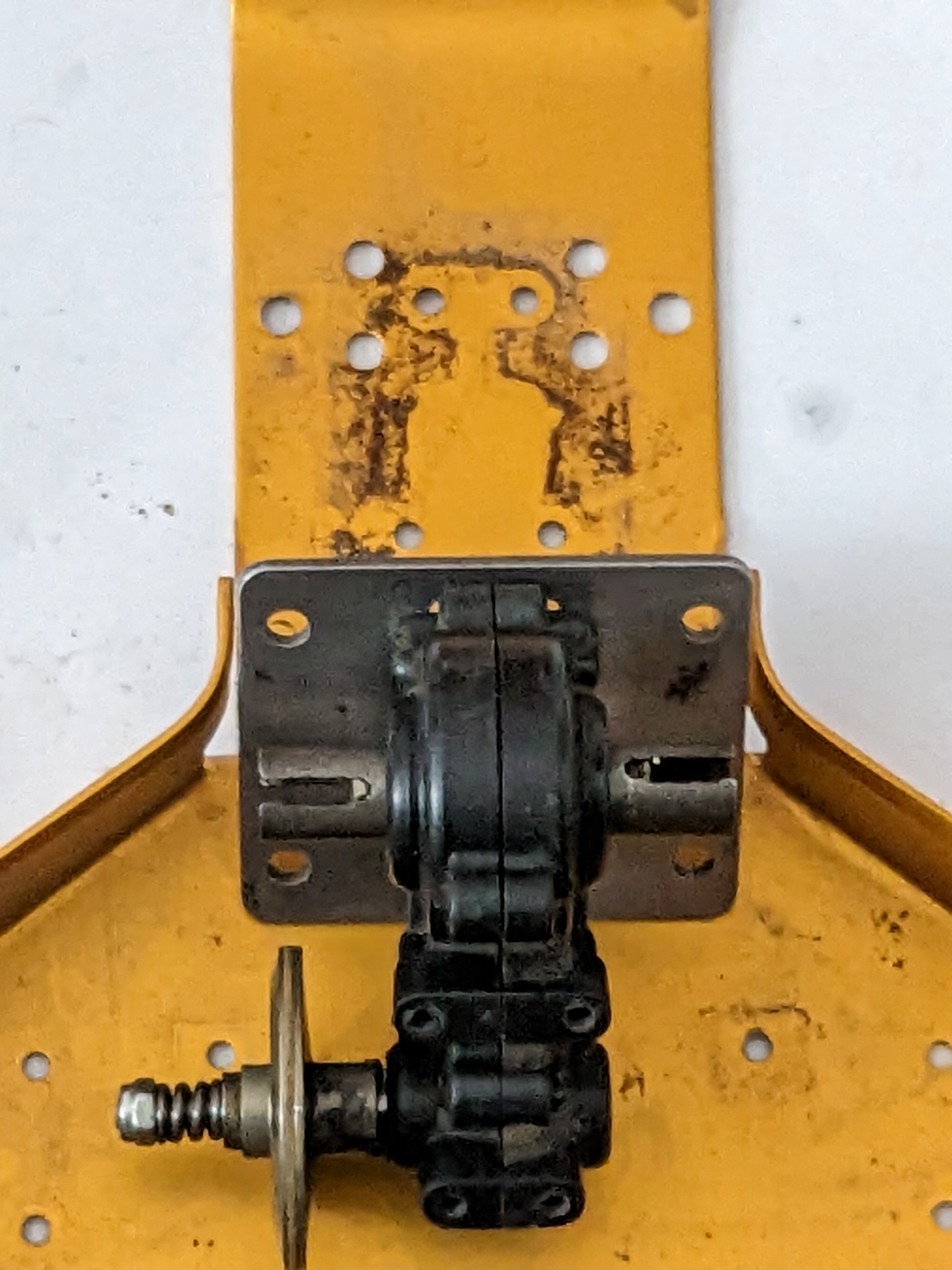

Posts: 3808
Has thanked: 2604 times
Been thanked: 2977 times
Re: RC10 with RC10gt gearbox?
Not a direct fit. Shown with Stealth drill template and B chassis.
