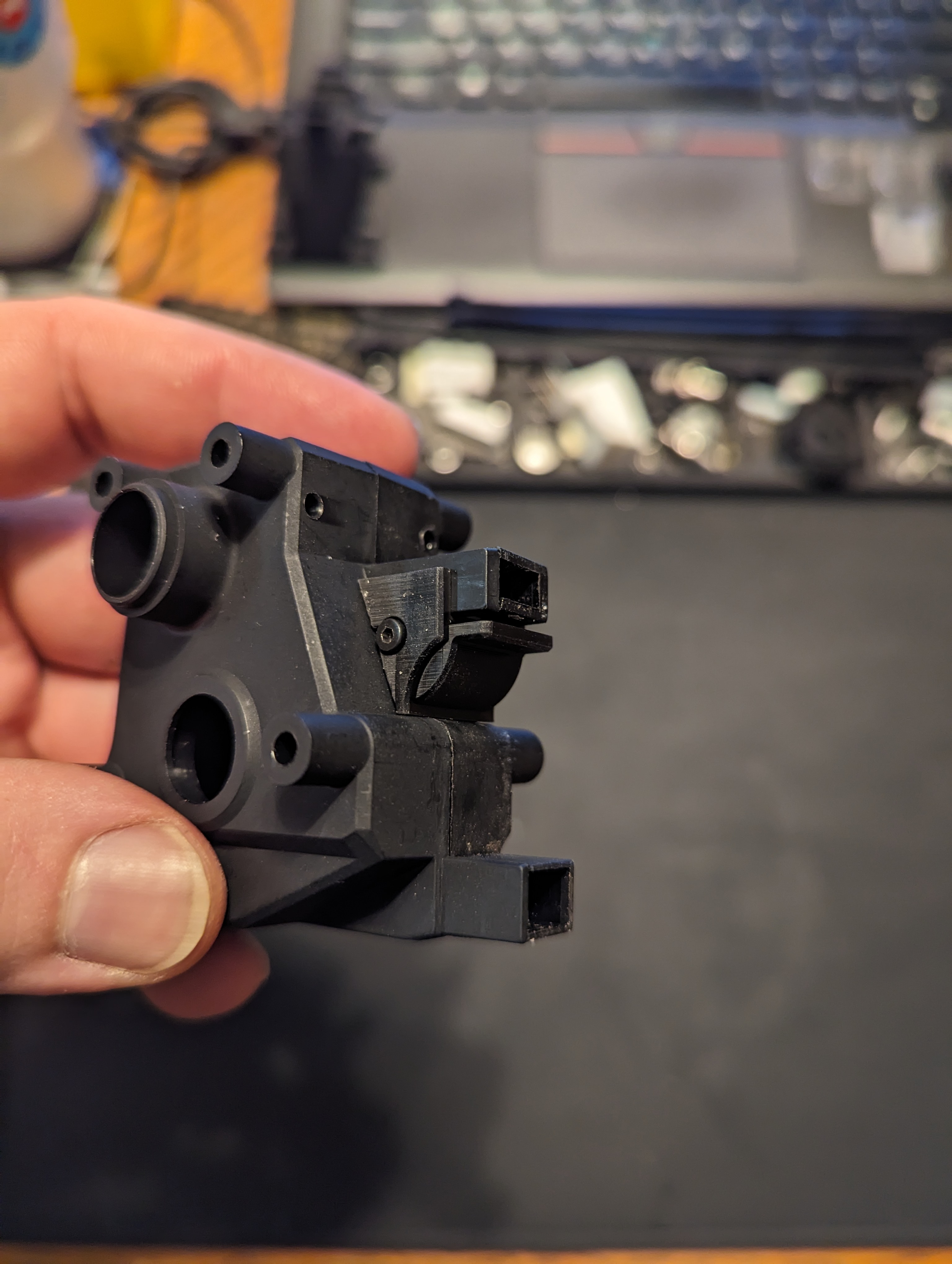

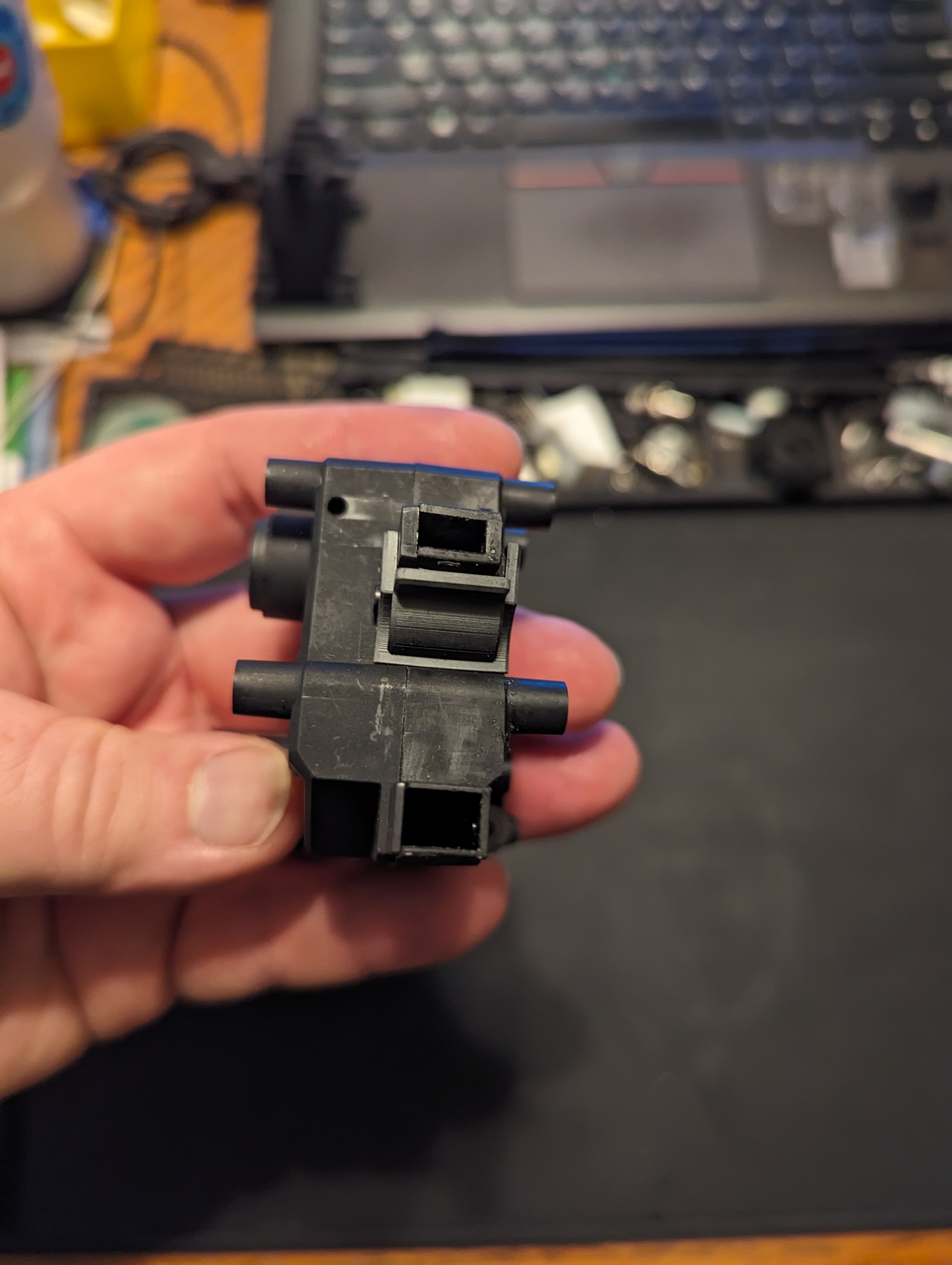

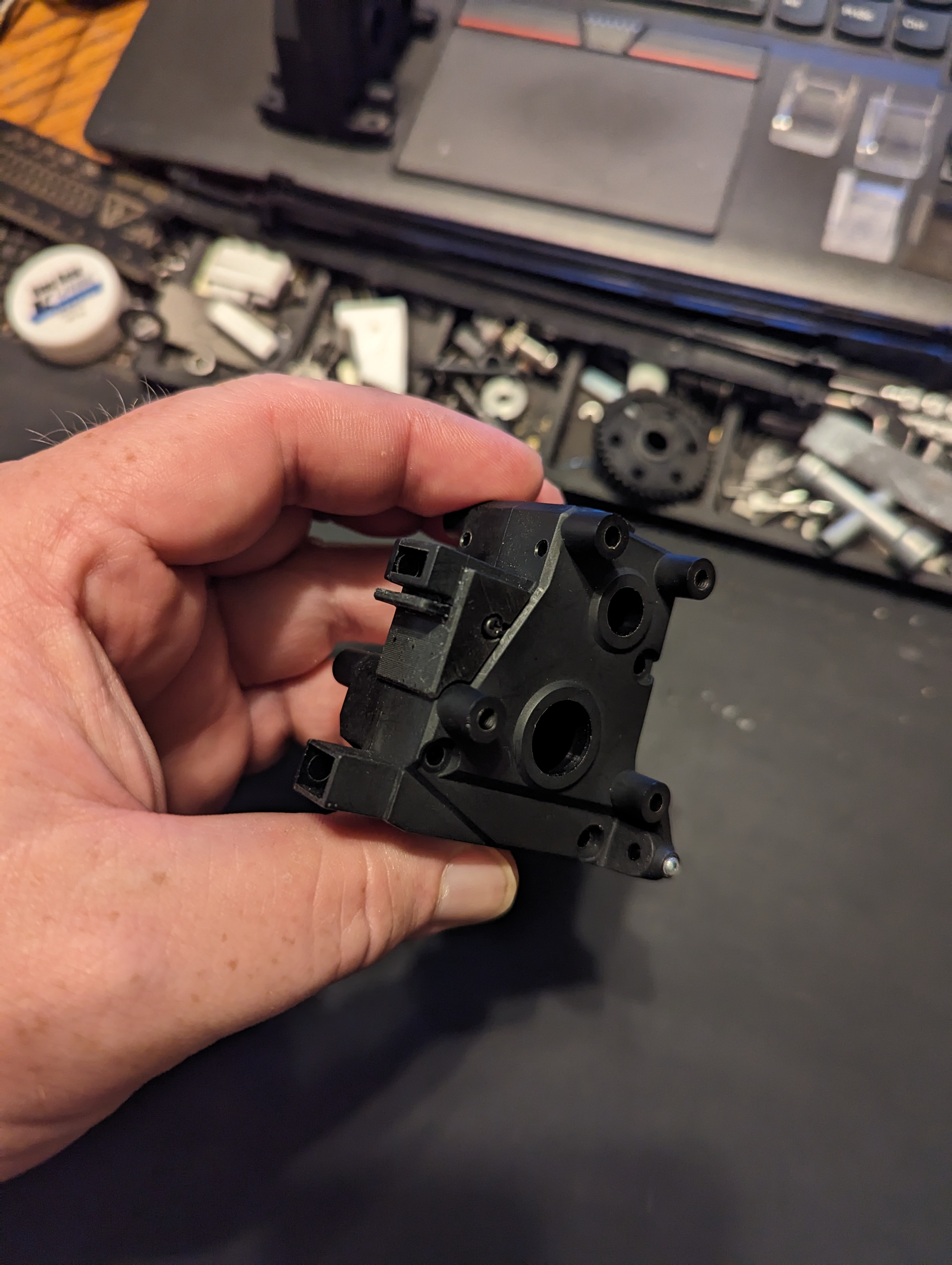

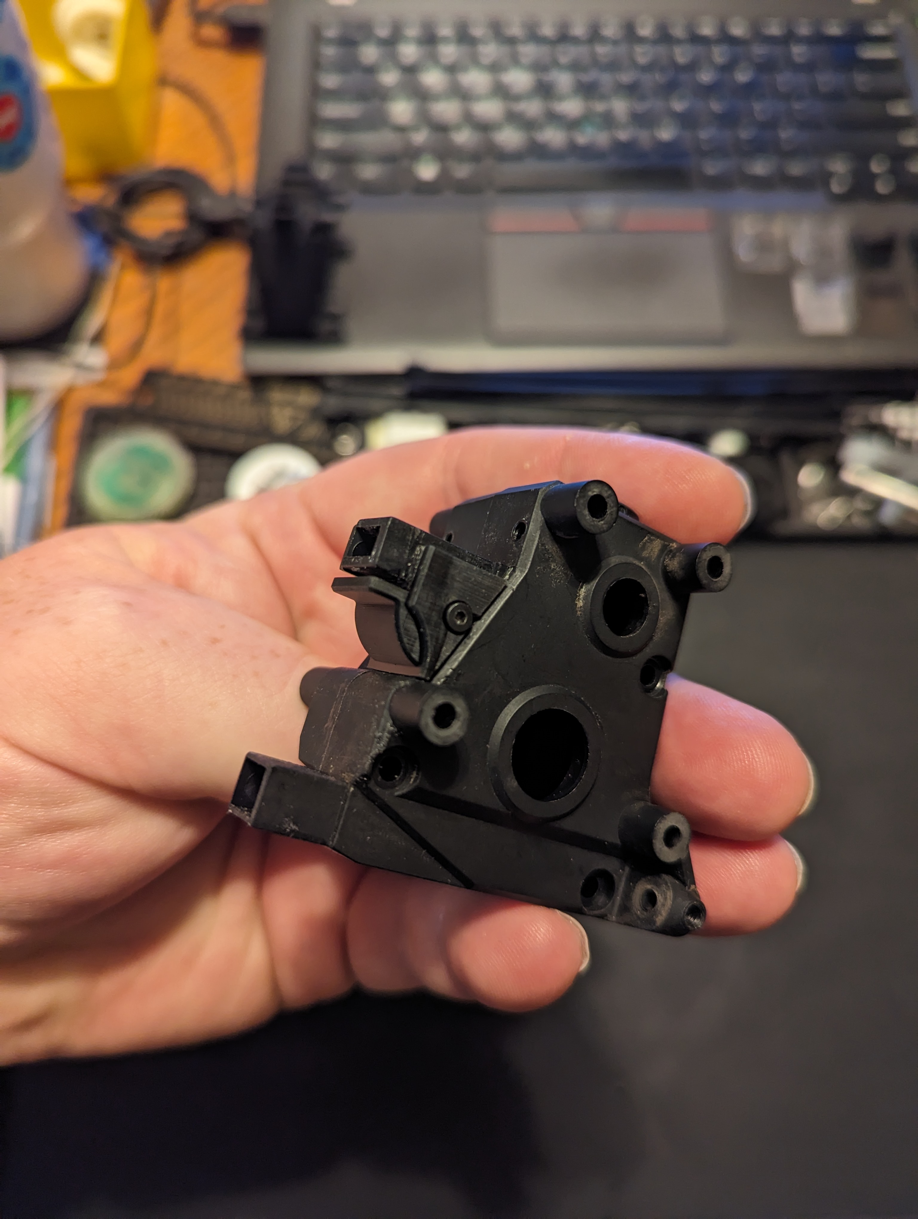

I have been resin printing these little replacement pulley covers for Kyosho Optima Belt Drive Conversions. ABS Like black resin. I like them, actually better than originals.
And this design does not look original but it actually works much better and is stronger.

Those pulley look covers look good... But I'm not sure that ABS-like resins are good for this type of use: deflection temperatures are quite low, and resistance may not as good as you expect.. You may have to consider Nylon like resins which are far much better in terms of resistance...

silvertriple wrote: Sun Jul 16, 2023 2:47 pm Those pulley look covers look good... But I'm not sure that ABS-like resins are good for this type of use: deflection temperatures are quite low, and resistance may not as good as you expect.. You may have to consider Nylon like resins which are far much better in terms of resistance...
Maybe, but temp should not be an issue, how hot could it possibly get The cover is just the little tiny bit that covers the opening you have to cut as a mod that Kyosho made instead of making all new transmission housings. I agree if it were the whole housing halfs, but it isn't even structural, it is literally just to keep the dirt out. It is also quite well protected from impact.
As per what I saw, most of the ABS resin temp deflection temps are around the same than PLA in FDM, some even slightly lower, in other terms about 50-55°C. Some friend was happy to show is PLA printed car a morning, he ran it and he stopped it as the motor plate was actually warping due to the motor temperature... He got the car back in his car and later on in the afternoon, he showed a superb piece of melted car... And it was not even a very hot day...
That's were I'm not too fan of the resins xxx-like : some of the characteristics are interesting and on par with the xxx material, but not all of them, and very often the deflection temperature is very different. Nylon-like resins may be a better fit, with better resistance and more flex, and deflection temperatures around 70-75°(which is still very much lower than Nylon, making it not suitable for gears, for example)...
