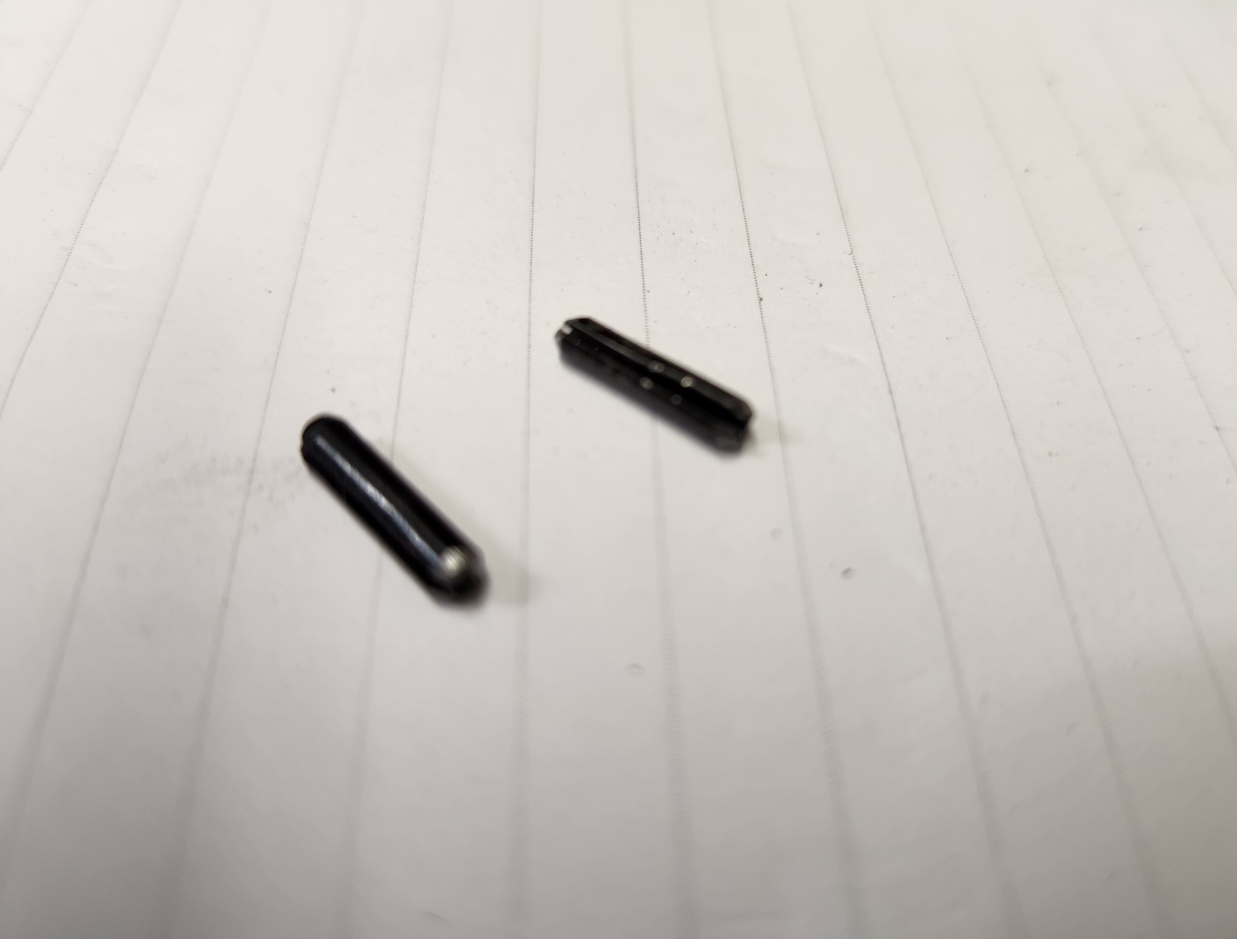

R6cowboy
Posts: 1498
Location: Mendota, IL
Has thanked: 896 times
Been thanked: 911 times
Re: How to get roll pin into rear axle
Post by R6cowboy »
GoMachV wrote: Sun Oct 13, 2024 10:53 am
I'll just need to whack a 1" incher in half (which will remove 1/8")
It sounds like the measure once cut twice then use the part you cut off to try again method :lol:
Definitely how it will go. In theory, one pin will make two. In reality, four pins later, I'll have my two good enough pins :lol:

R6cowboy
Posts: 1498
Post by R6cowboy »
Miraculously, one 1 inch pin became two 7/16" pins on the first attempt.
-Jerry-
