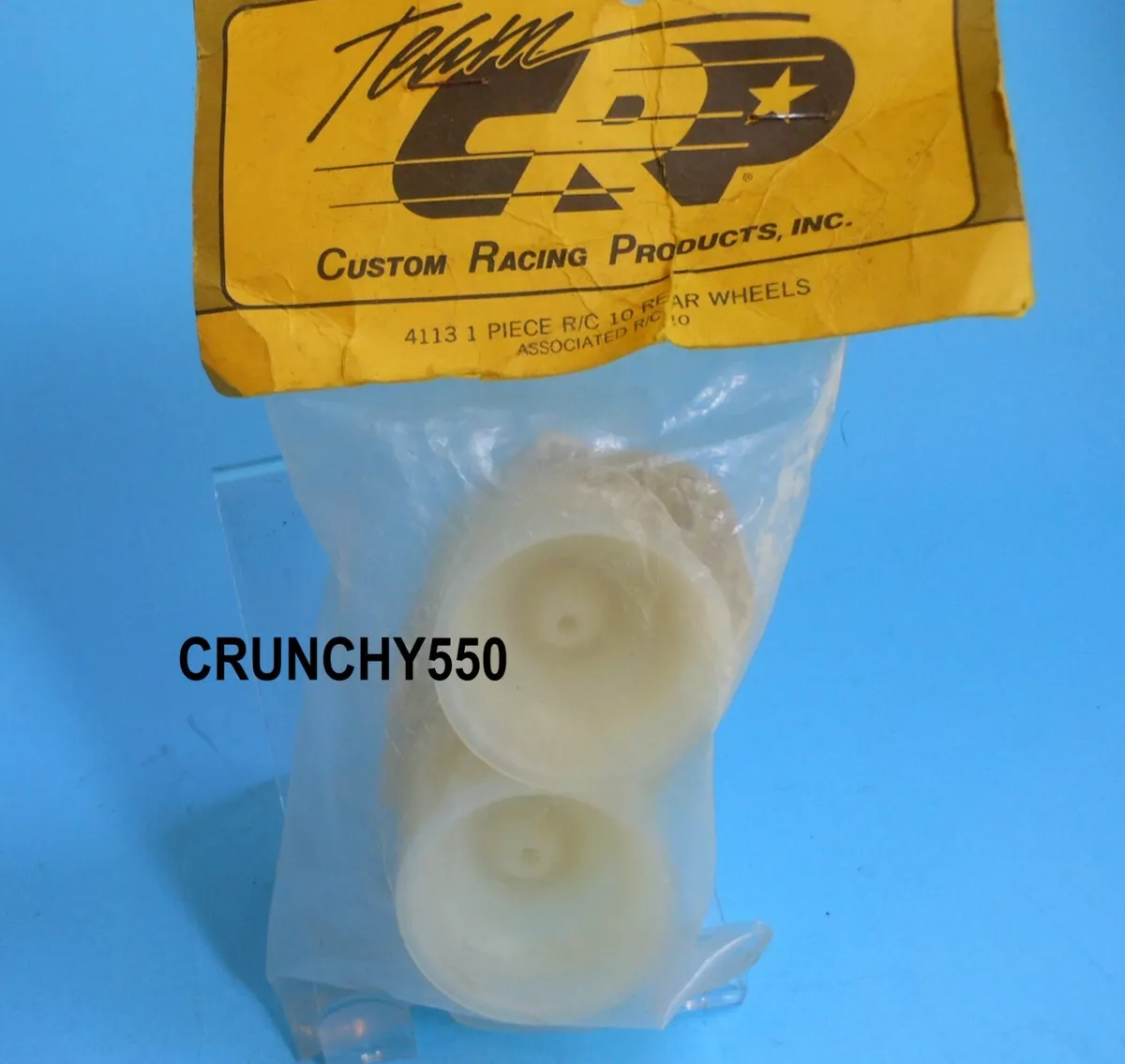

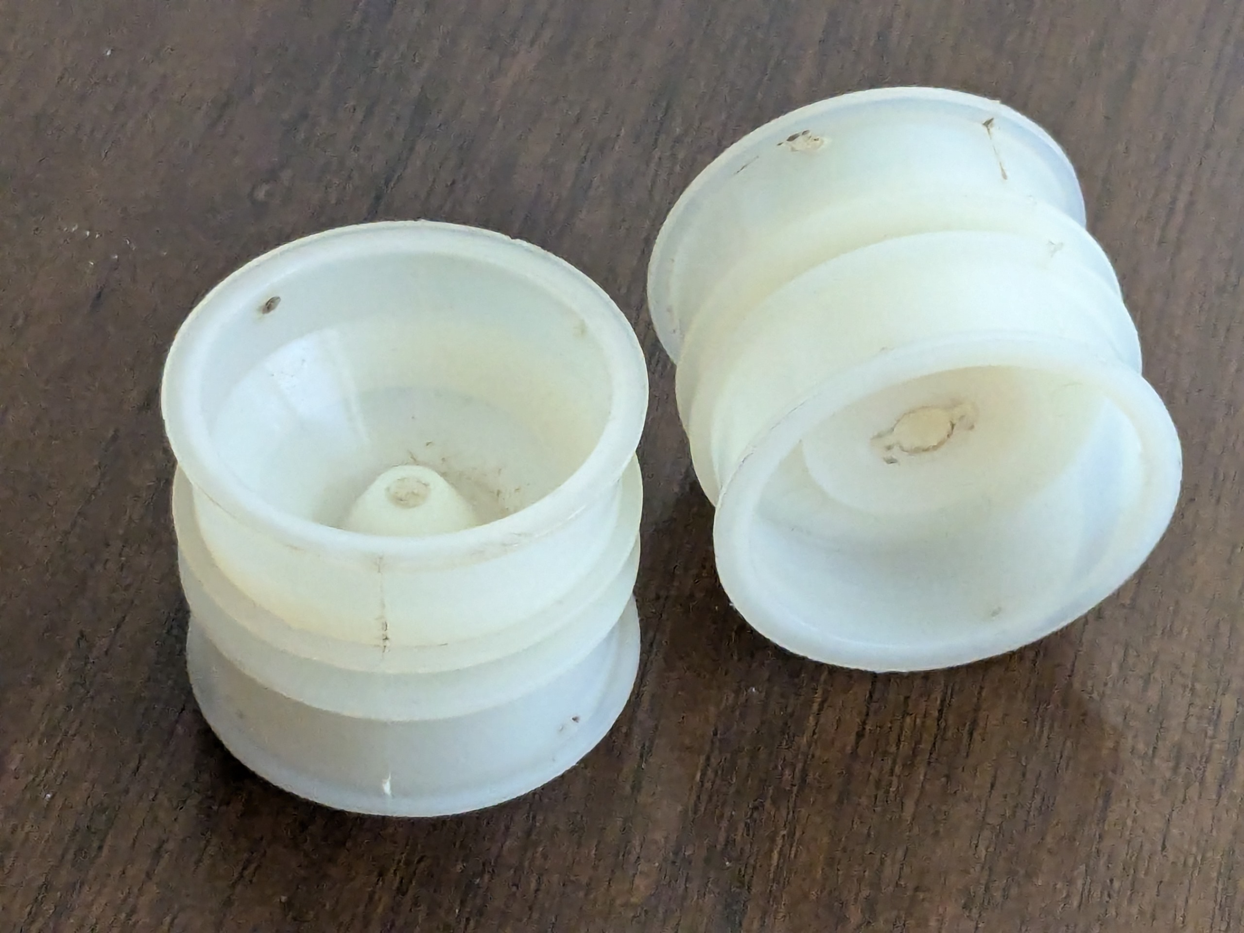

Anyone know who made these wheels, and if there's a similar style front wheel?
Posts: 12336
Been thanked: 3919 times
Those look like the CRP, and I don't recall a matching front. Their fronts had holes.
