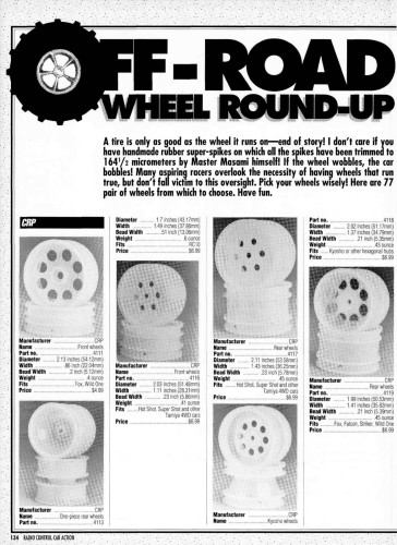

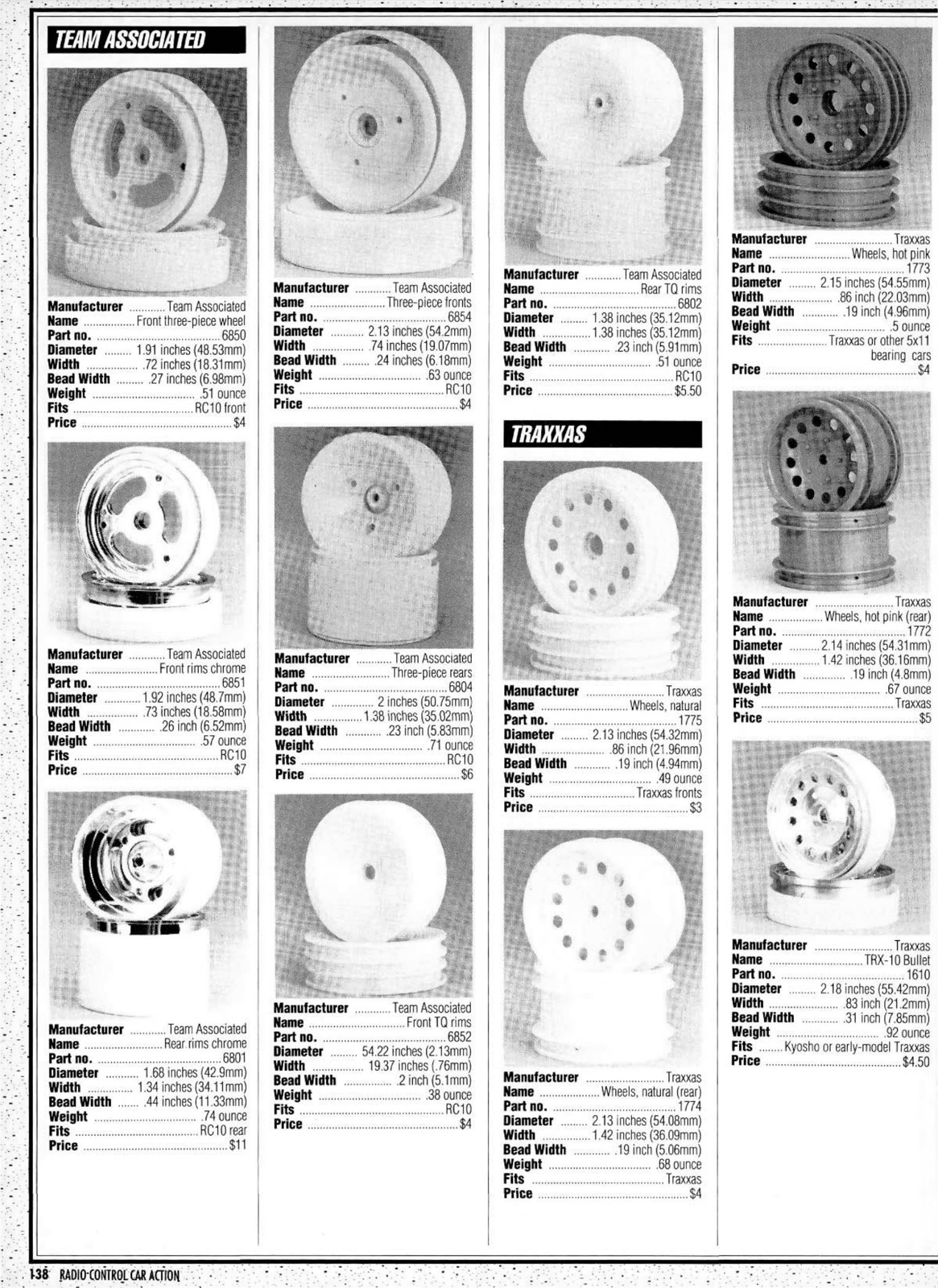

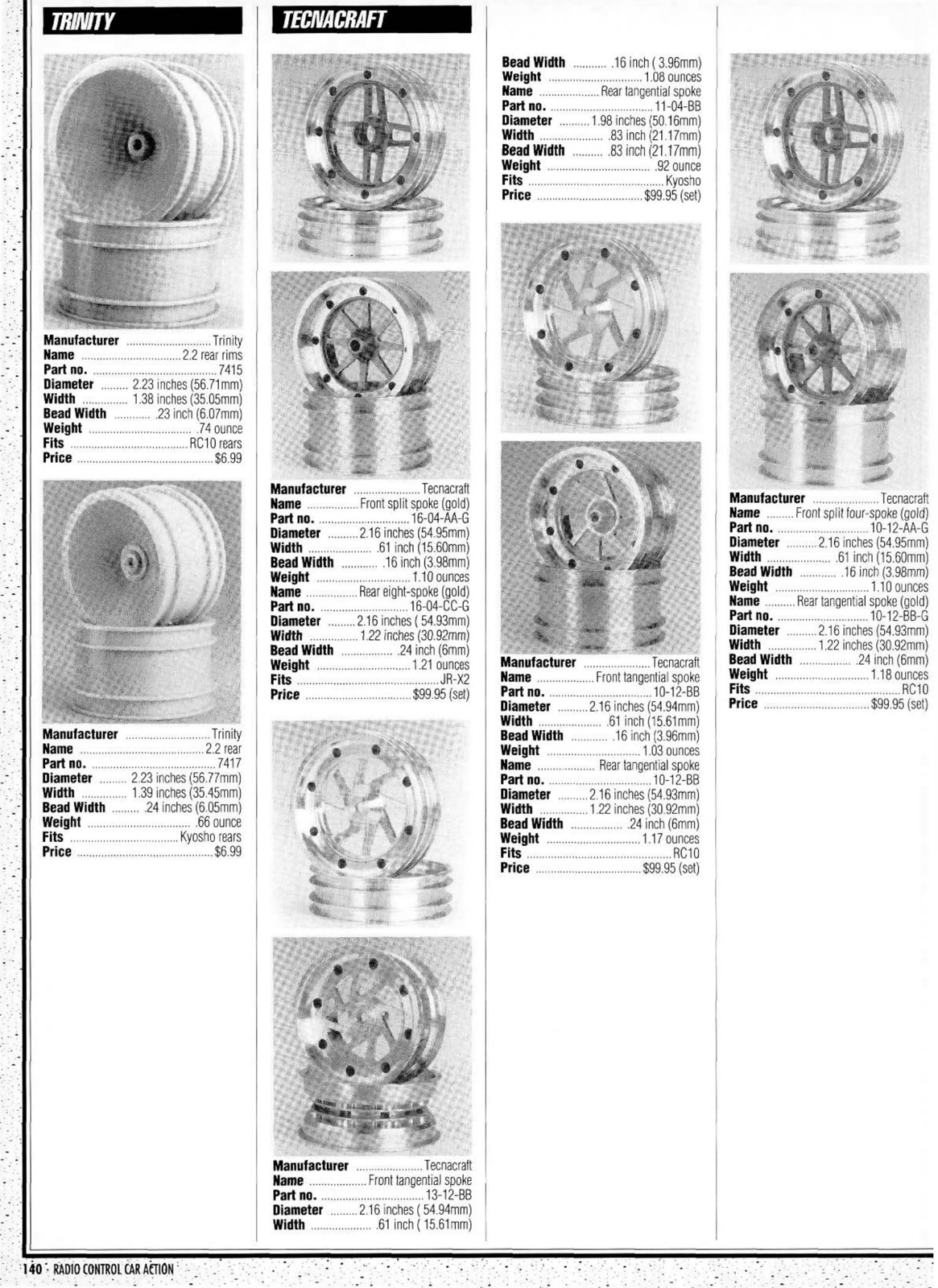

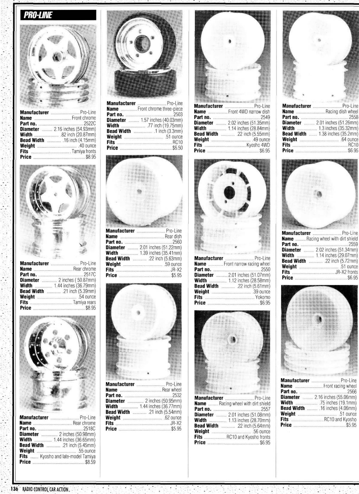

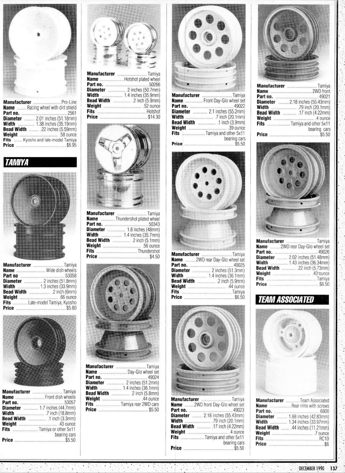

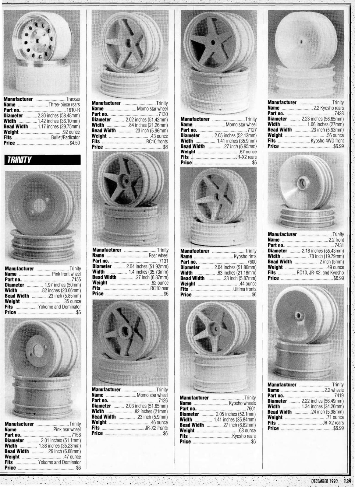

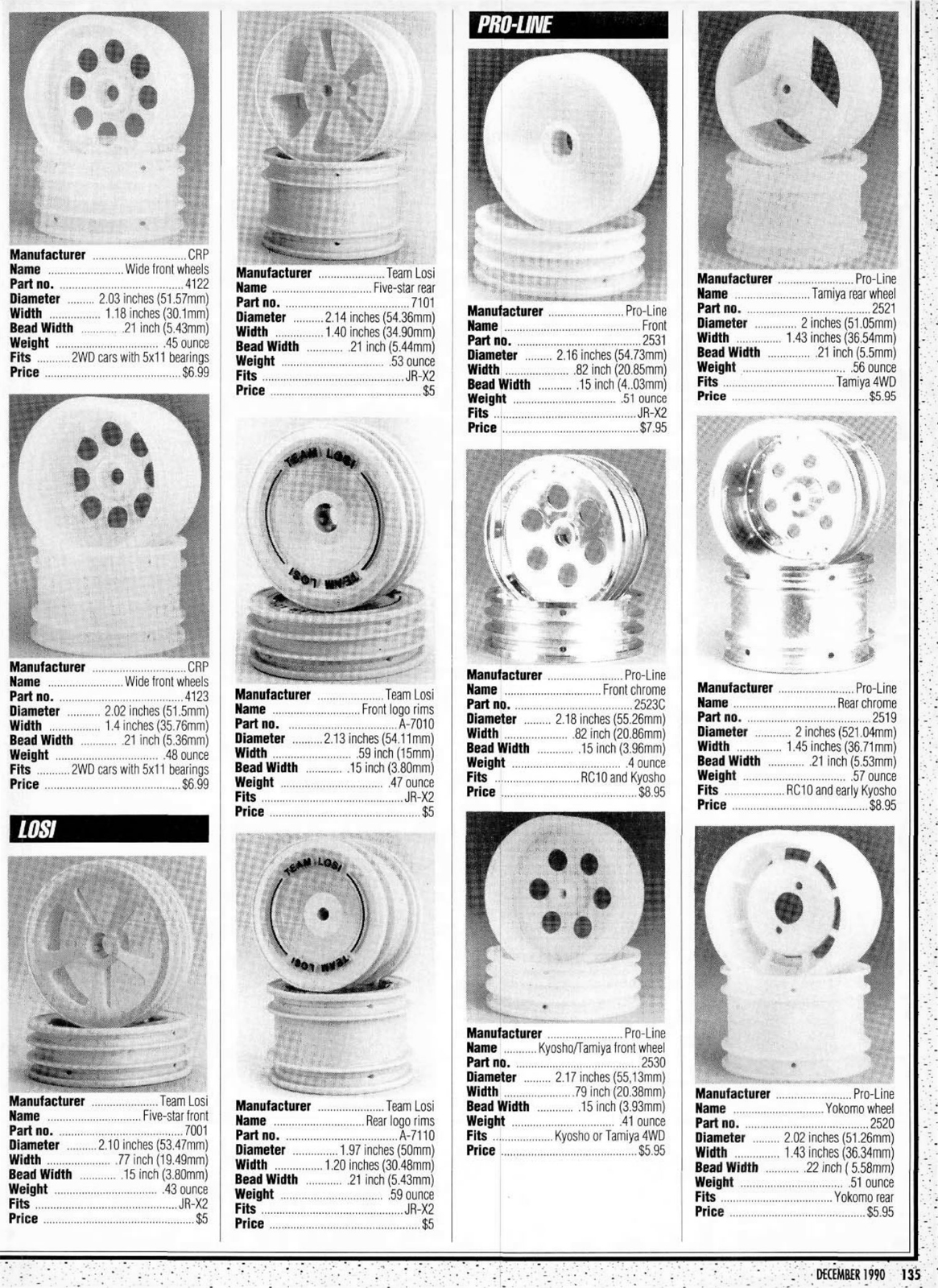

Wondered across this while searching for other cool things... from the December 1990 issue of RCCA... no backspacing info, but has wheels weights, should your graph need another column

Thats super cool! And also good idea adding weights might be on my to do list.Dangeruss wrote: ↑Fri Aug 09, 2024 8:18 pm Wondered across this while searching for other cool things... from the December 1990 issue of RCCA... no backspacing info, but has wheels weights, should your graph need another column
