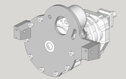

The many added benefits of having a printer are slowly become apparent. For instance, the aluminum motor plate and mounting blocks require many precisely located screw holes so I quickly printed drill templates for these parts.
I simply glued the templates to the blanks and drilled the holes using my drill press.
During trial assembly and test fit, the screws literally fell into place. Nice! :mrgreen:

templates and jigs make fabricating non 3d printed parts so much easier , for more advanced stuff you can model up complete assembly's virtually before you ever get close to tools

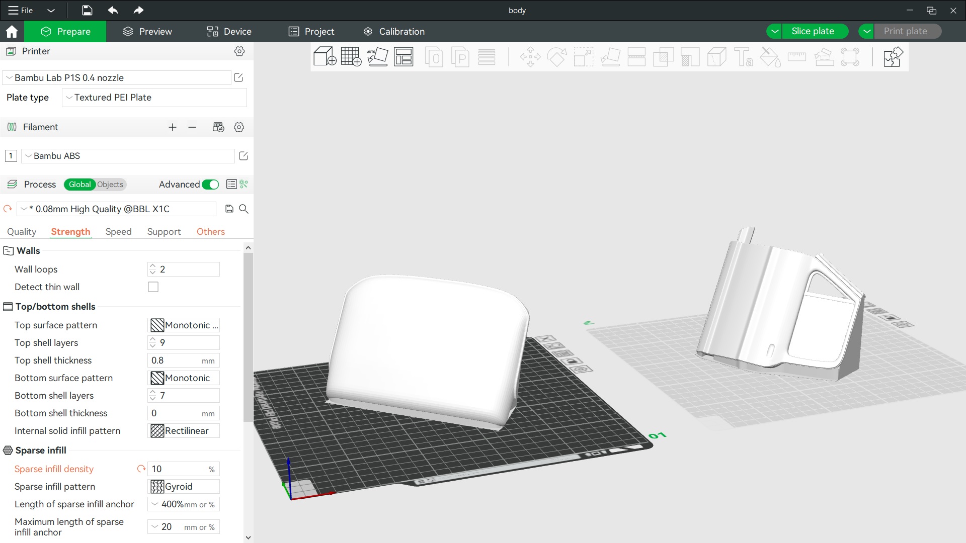

I'm preparing some body panels and queing them in the slicer for printing and I'm looking for some advice.
This is my first time printing ABS and I will run flow dynamics and flow rate calibrations before proceeding.
It's my understanding that bed and layer adhesion failures due to shrinkage is a big problem with ABS so I'll run the recommended extruder and bed temps and keep the door closed while printing.
Is there anything else I should do to ensure good quality prints?

I've had zero issues with abs, that's my go-to for basic functional parts. I think you will be just fine.
Now, it is a bit stinky, really needs to be dried, and you definitely want a little glue down ... But otherwise I'd say just run the print..

GoMachV wrote: Fri Feb 21, 2025 4:05 pm I've had zero issues with abs, that's my go-to for basic functional parts. I think you will be just fine.
Thank you sir.
I forgot to mention that I will use PEI textured plate and I also forgot to ask about glue -- glad you mentioned that. This is what I have on-hand.
The filament (also from Bambu) is new and still in the wrapper and I won't open it until I'm ready to print. Do I still need to dry it?

Thats the glue I use as well. As far as drying, I have ran them straight out of the package but we are pretty dry here as well. Id give it a shot, but ideally id recommend drying it
