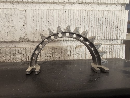

Closest I can do is a printed steel gear I made for our fireplace damper 🤣 If you do the chat thing with SCS you can send them your file and they will let you know if they see any issues with their process.

Sendcutsend is a laser or water jet cut on a flat metal, not printed. I was just showing a printed steel gear I had made is all
