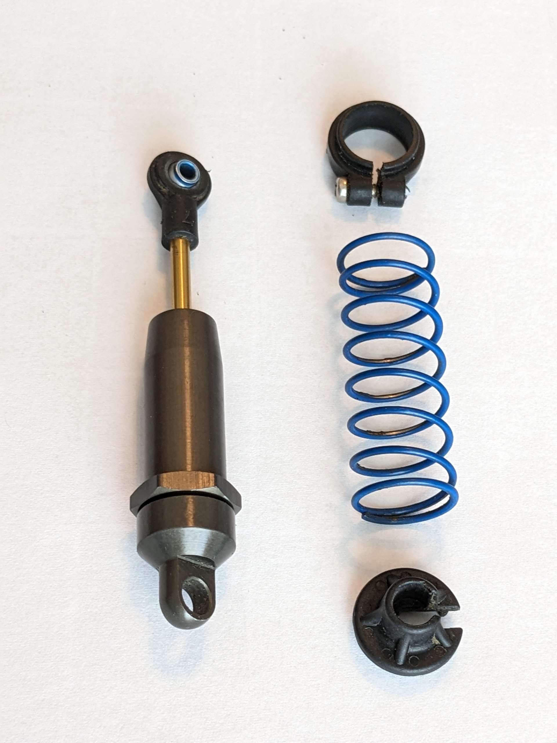

So this bottom loader shock with matching end cap seems like an Associated clone, but I'm not sure what it goes to. I just have this one, but might like a set of them.

Traxxas hard shocks, still available. Good shocks!

Frankentruck wrote: Wed Jun 12, 2024 2:34 pm So this bottom loader shock with matching end cap seems like an Associated clone, but I'm not sure what it goes to. I just have this one, but might like a set of them.
GoMachV wrote: Wed Jun 12, 2024 2:52 pm Traxxas hard shocks, still available. Good shocks!
They list them as their "Big Bore" shocks, even though they are standard size.
But as Jeff said, they are good shocks.

juicedcoupe wrote: Wed Jun 12, 2024 3:25 pm
Are there different versions? F-ntruck's seem to have octagonal caps vs smooth/round, different bottom spring retainers, coated shafts, and beefier rod ends.

Yes, Frankentruck has one of the newer versions. Over the years running changes were rod ends, spring cups, caps, color variations.
Frankentruck has the round cap.
Good shocks but were very limited on springs early on. Tbh, the might not have come with gold shafts in the early days but not sure on that last part.

1911Colt wrote: Wed Jun 12, 2024 3:32 pm
I added another view of mine. I did a quick Traxxas check and there do look to be different cap and body options, and prices seem ok on them.
Looking at my 'shoved in the corner for future project' TRX-1, the shocks with it look very similar. I just wasn't thinking about them I guess.

Well when it's listed as an RC10 shock...

Traxxas long front shocks part number 4760 looks like traxxas have very resently deleted them from production but they’re still around on eBay etc. they were originally produced in blue ano then when to a light grey hard and with blue caps on the trx-1 and blue eagle onwards and more resently the dark grey bodies. The rear x-long shocks th match are part # 4761.
The “big bore” versions are part numbers 2660 and 2661 and where on the trx3, tcp ,SRT onwards they have a stepped cap and a step on the bottom of the cylinder where the seals go in aswell.
Franks eyelets look to be kyosho maybe? Definitely not original traxxas
The last set I bought had the gold shafts in the rears but not the fronts was really disappointing
