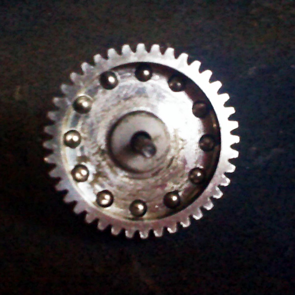

Phin
Posts: 2818
Location: NY²
Has thanked: 87 times
Been thanked: 248 times
Re: Mip transfer sp1 question
Post by Phin »
Here ya go. Took mine apart and snapped a pic. Different diff gear.

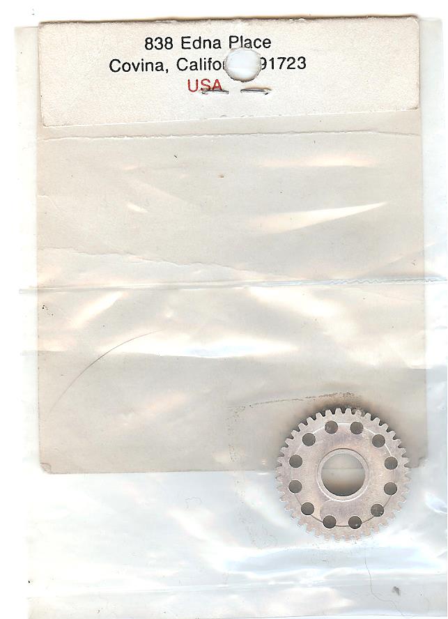

aip47-2008
Posts: 1191
Location: Spokane, WA
Has thanked: 170 times
Been thanked: 23 times
Post by aip47-2008 »
gomachv wrote:I wonder if they ever had a "pro diff" version, I don't see why you couldn't fit a bearing in there if you get the measurements right. It's gonna be thin.
It will sound silly but I have used play dough for things like this, pack it in there, assemble, and remove carefully. That will give you the bearing width max. Don't use it for diameters, it won't be centered.
They did offer the pro ball raced differential kit that also fit into the same gear box. He has the wrong diff. gear for sure.................needs B-3. Show some more pic's of the other parts. Does not look right!
Aaron
