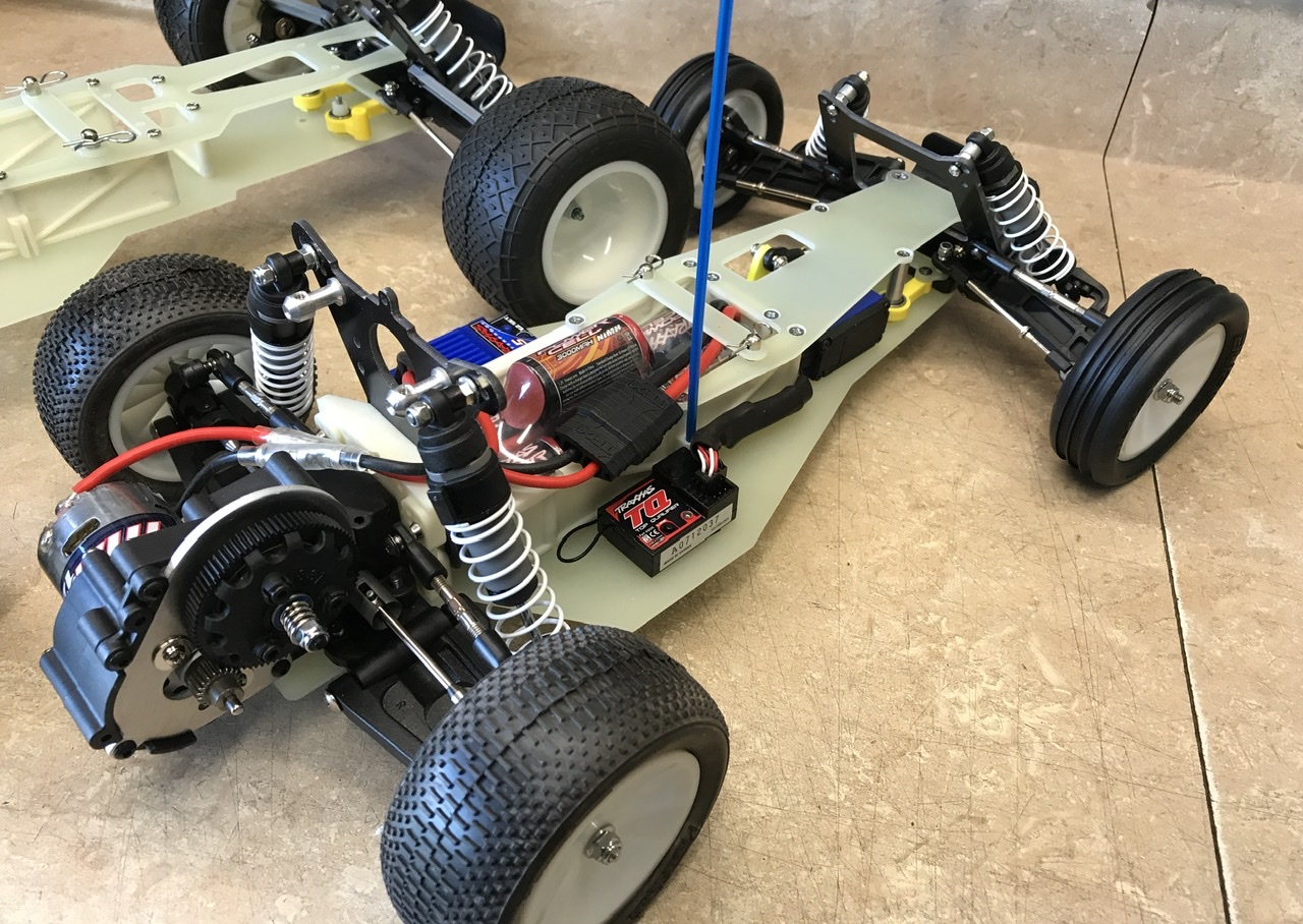

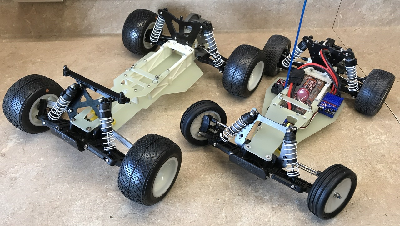

The biggest drawback to the bandit is the truck length chassis IMO. If you get wanting to make it more of a racer let me know- this is our TRX-b conversion. Only part that is discontinued is the battery box, and they are around $10 on eBay. (Shown with an RPM trans, the new trans from the drag truck would be an awesome upgrade for the money. Sealed diff, aluminum motor plate etc)

Those look like pretty sweet setups!

Well those sure are pretty! I love double-deck chassis like those. When Associated and Losi buggies started moving away from aluminum tubs and flat plate chassis toward molded tubs is when I started losing interest way back then. Those look fantastic. Does your Bandit chassis shorten the wheelbase? And dare I ask how much they cost? And what dogbones are those?GoMachV wrote: ↑Wed Jul 21, 2021 3:11 pm The biggest drawback to the bandit is the truck length chassis IMO. If you get wanting to make it more of a racer let me know- this is our TRX-b conversion. Only part that is discontinued is the battery box, and they are around $10 on eBay. (Shown with an RPM trans, the new trans from the drag truck would be an awesome upgrade for the money. Sealed diff, aluminum motor plate etc)

Yeah we offer two lengths, bandit length and trx-3 length. I want to say the trx3 is around 1/2” shorter or so. Makes fitting batteries tough but most seem to run the shorties which are perfect. The worst part by far is the servo fit. I left the design alone and it’s a tight fit with a servo saver. We include our ball bearing bellcranks which does make things a little easier. Running a strong servo and no saver would be a way better fit than a servo that needs a saver.
The bones are our old A&L dogbone conversion. Unfortunately they are gone now. Sold out a couple years back. We have some longer bones left for the lethal weapon conversions and the other pieces but nothing for the stock style trans.
Best to pm for pricing info, not really supposed to sell outside of the proper forums even though we are a business.
