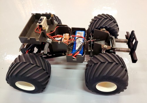

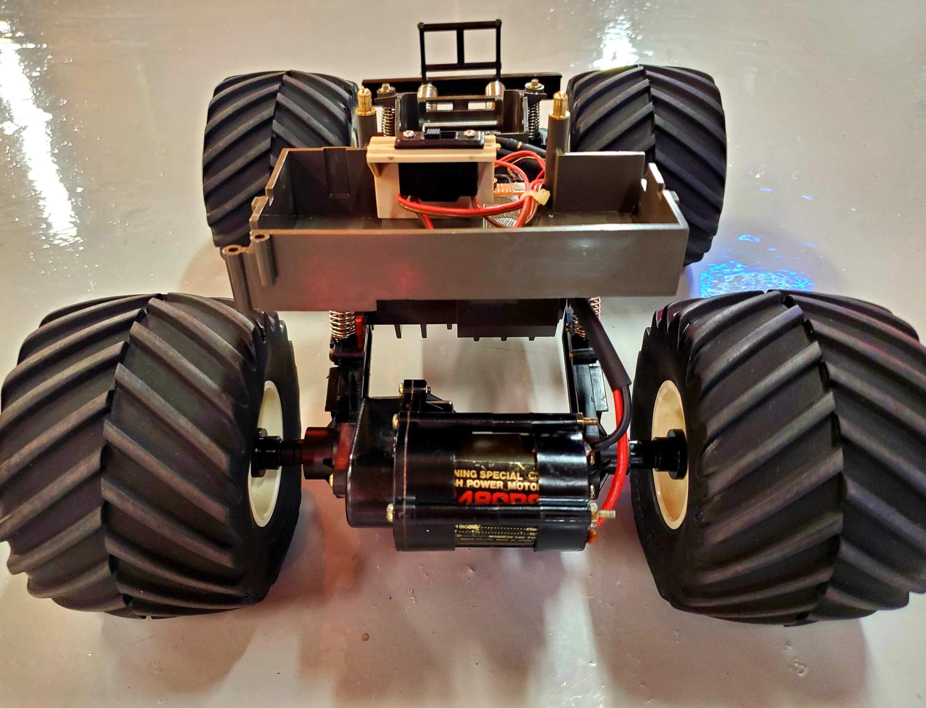

Finally got around to restoring this....body still has to be done.
Went with a new vintage Parma wiper speed control with brake and scored and original M480RS motor....this was me and the Diamond One's 1st ever rc back in 86' so it's way up there on our list

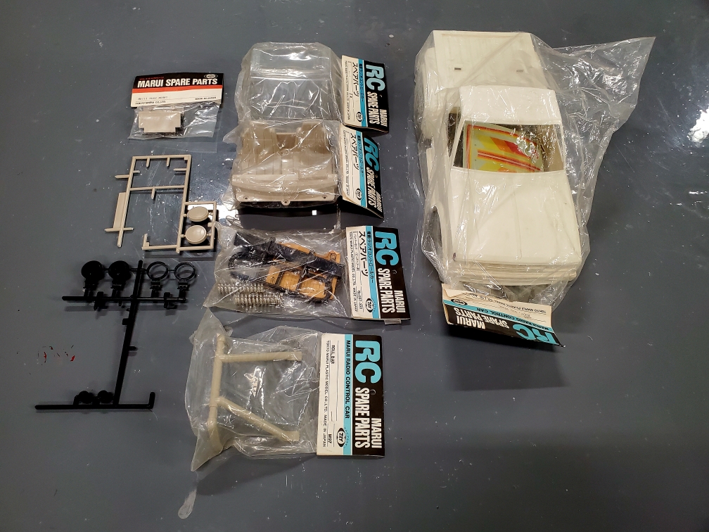

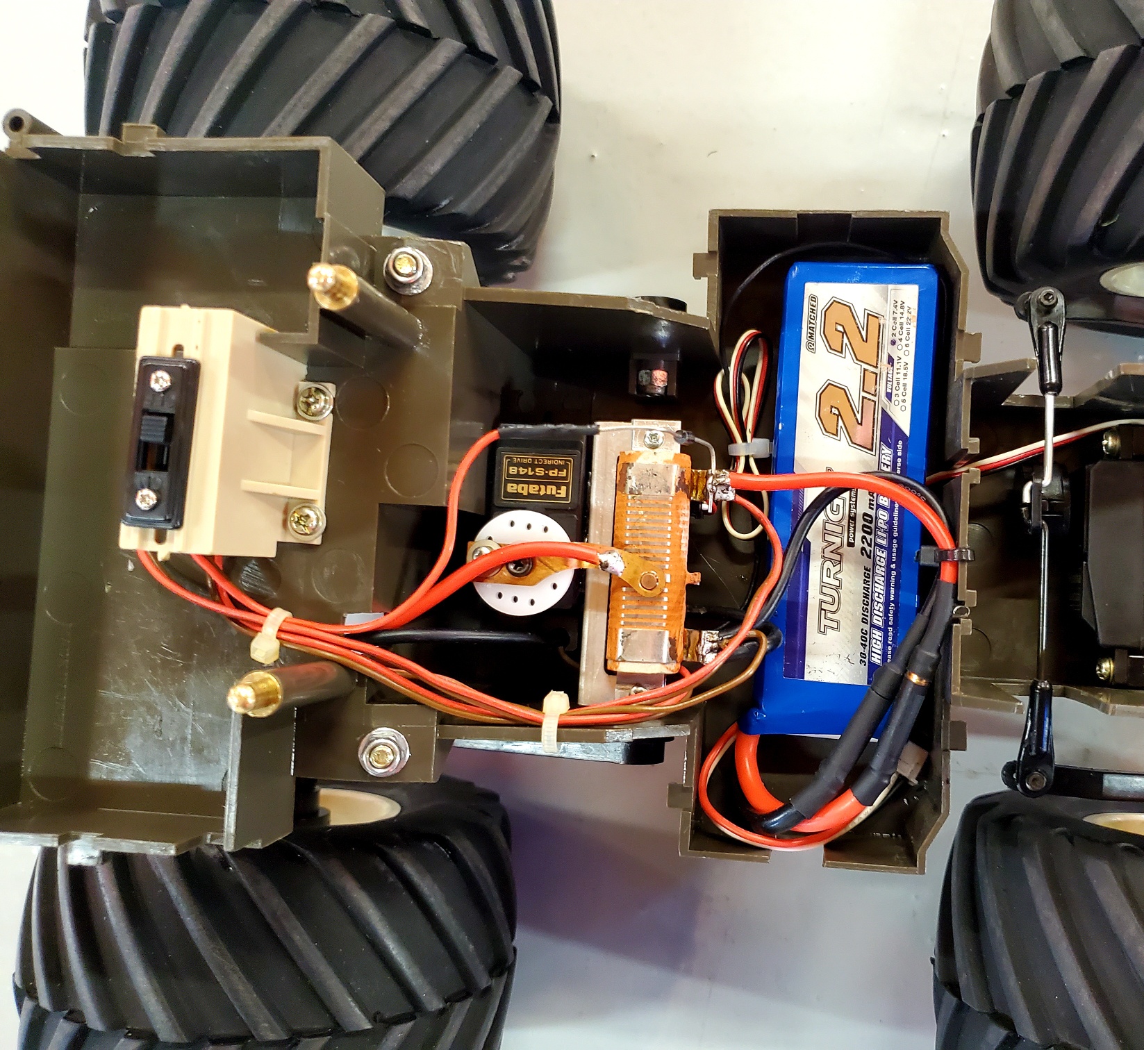

Scored this for the resto
That Lipo will be gone that's in it!...
Can't stand any Lipo/Brushless in any vintage build...yes I have done it too many times..but I still hate it

I can understand for the Brushless being an issue to keep a car in the mood of the eighties... That said, brushless have an enormous advantage: well geared, it doesn't heat. And with those plastic gearbox, if you run it is quite important.
That said, one thing that I noticed when tackling my Big Bear is that current range of 540 is slightly larger in diameter than plain old ones : I splitted a gearbox due to this with a 540 silver can...

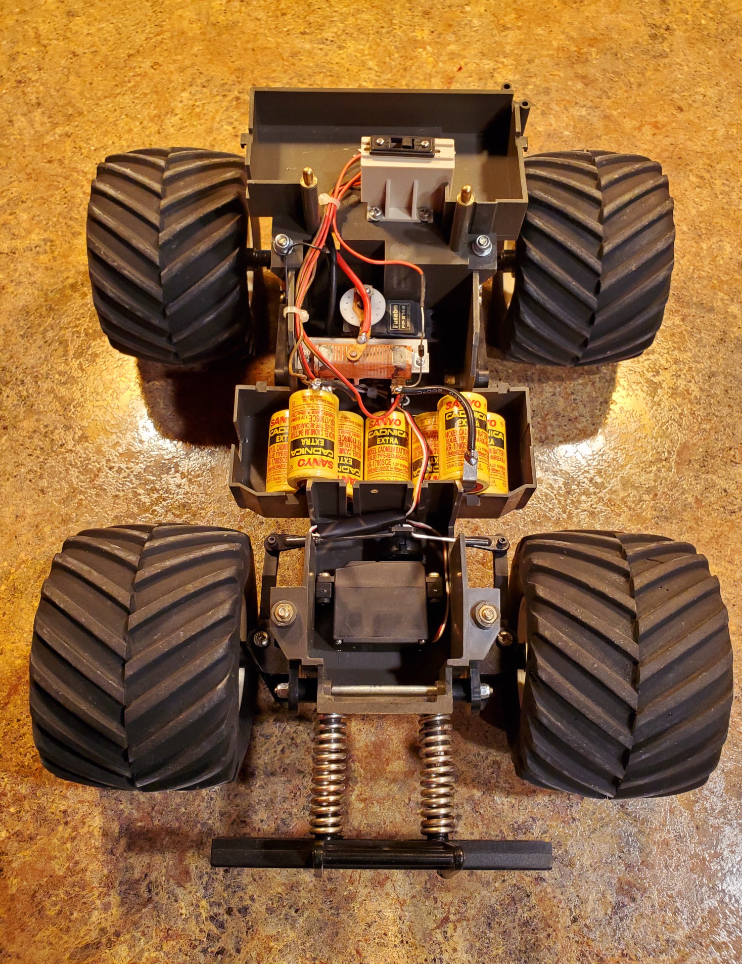

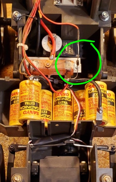

Built this cool 7 cell pack...got rid of that hideous lipo...i ran it!....runs strong....body next...that Parma msc is the
!...so smooth

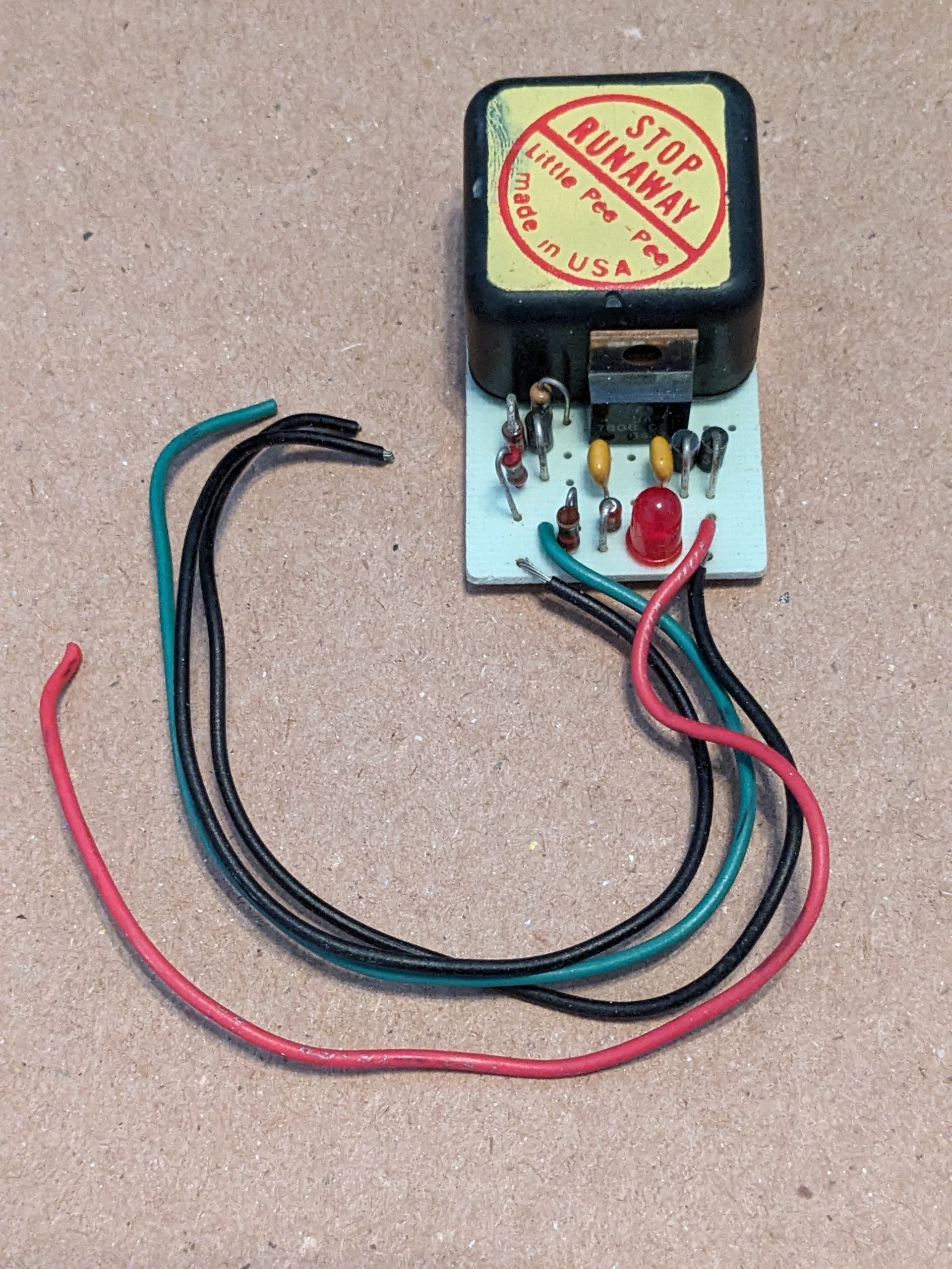

Are you running a 4 cell battery pack for the servos? I don't see it.
If not, your Big Bear might need a Little Pee Pee.

Thats freakin cool as hell!Frankentruck wrote: ↑Tue Jan 30, 2024 6:09 pm Are you running a 4 cell battery pack for the servos? I don't see it.

That is cool..i.have 7 cells with a diode backing voltage down to receiverFrankentruck wrote: ↑Tue Jan 30, 2024 6:09 pm Are you running a 4 cell battery pack for the servos? I don't see it.
