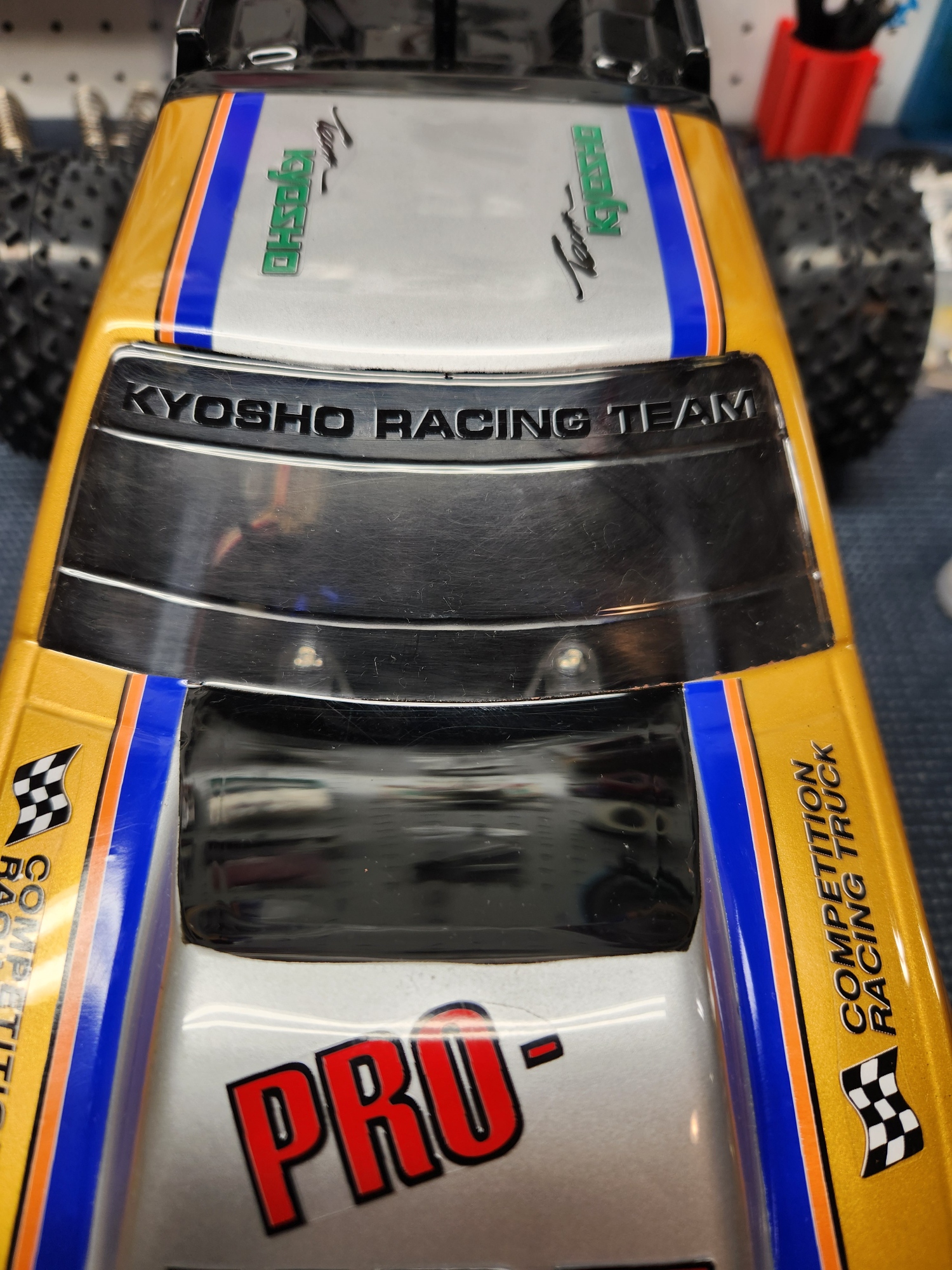

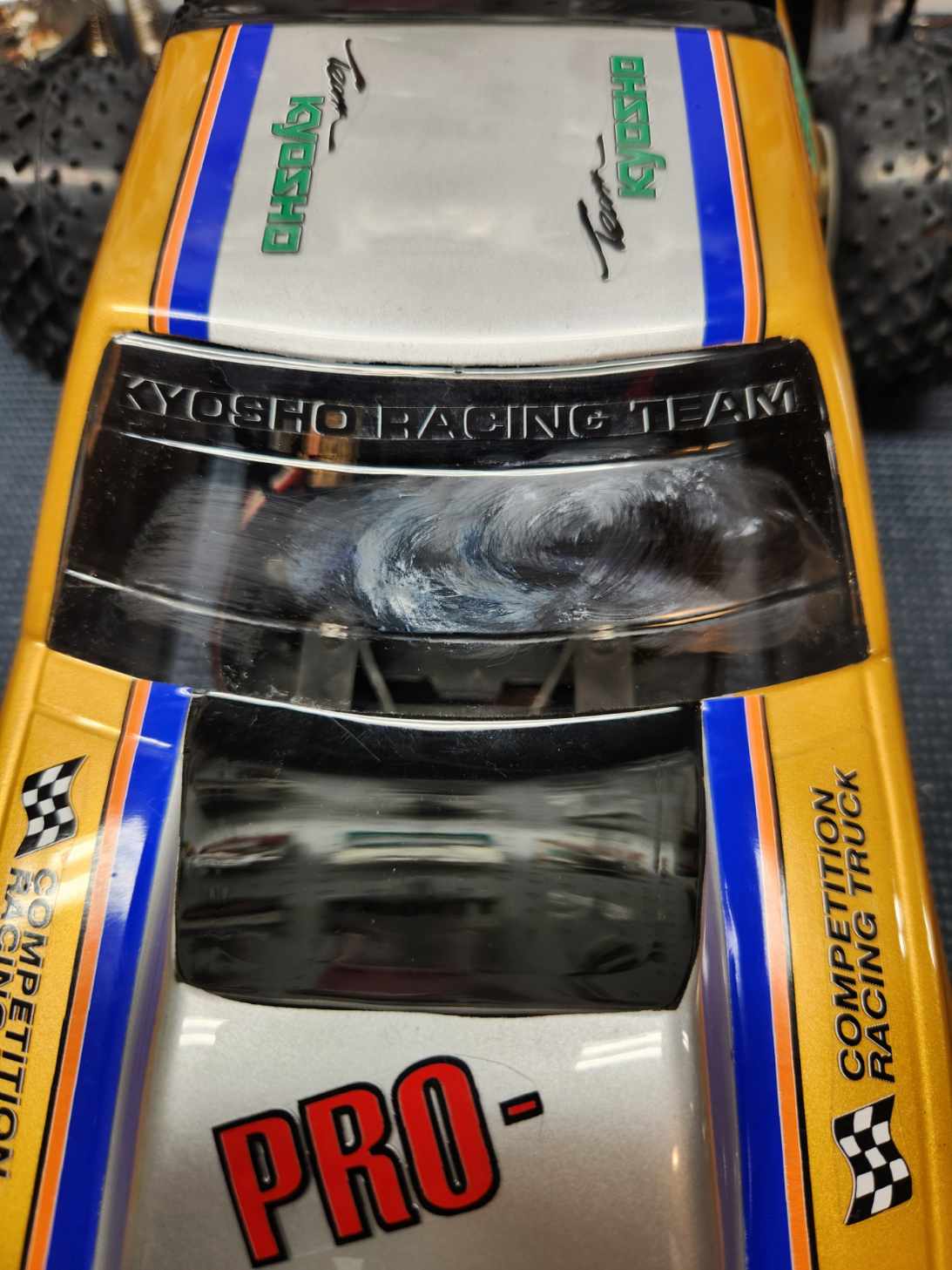

I made the remarkably stupid mistake and grabbed the adhesive remover to remove tape residue from a lexan/polycarbonate body, which I've done before years ago but apparently didn't learn my lesson.
Got some tripoli polishing compound and went to work with a small rotary tool and cloth polishing wheel. Applied two rounds and here's the before and after. It's "livable", but still very pissed at myself.
Before
After

The 'after' has a vintage RC look to it. Good recovery.
