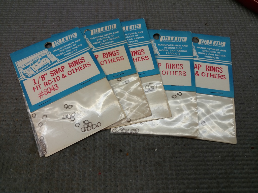

Interestingly, even though this thread has been brought back to life after more than six years... I have a NIP set of these Parma bits in a lot I'm selling on eBay at the moment.....Lowgear wrote: ↑Sat Apr 14, 2012 5:48 pm An alternative to e-clips are snap rings aka circlips which have been used and sold for R/C applications. Although I imagine they would catch on more things once the part that protrudes orientates itself towards the ground.
(Pic stolen from eBay)
Those are a little odd as I'm not sure how they go on. Hopefully there's a slit where the square hole is.

Re: E-clips keep popping off.
I think we messaged yesterday about them. Are your Parma units gold colored?Incredible_Serious wrote: ↑Mon Jun 18, 2018 5:22 pmInterestingly, even though this thread has been brought back to life after more than six years... I have a NIP set of these Parma bits in a lot I'm selling on eBay at the moment.....Lowgear wrote: ↑Sat Apr 14, 2012 5:48 pm An alternative to e-clips are snap rings aka circlips which have been used and sold for R/C applications. Although I imagine they would catch on more things once the part that protrudes orientates itself towards the ground.
Those are a little odd as I'm not sure how they go on. Hopefully there's a slit where the square hole is.![]()
Do you mean the Parma retainers, like the photo above? I bought some from Scr8p (don't have them yet) and was wondering how you fit them on, or if a special tool is needed.NomadRacer wrote: ↑Thu Jun 21, 2018 4:47 pm I have the correct pliers for the snap rings. I bought them during the era when the rings were popular for off-road. I Don't have any snap rings to go with them.![]()
If you could post a picture of the tool, that would be awesome. Or, if you want to sell it, let me know. Thanks.
Ok. I actually have a set of those. I thought the Parma retainers may use something different, because they don't look like a regular snap ring with the two loops for the tool. Take a look at the Parma retainers. From the photos I cannot tell how they open, but I am sure I will figure it out once they arrive. Thanks for all the help!NomadRacer wrote: ↑Sat Jun 23, 2018 8:55 am @lavigna
They are the same, just instead of two small holes it’s two small half circles due to the tiny amount of space
Finding a pair of external retaining ring pliers with tips that small isn’t that easy. They are out there, but not like a Harbor Frieght or Sears kind of thing.
